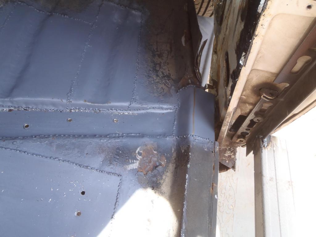

                          • I wasn't anxious to work on the passenger side floor, but a little at a time will eventually get it done.
                            Started cutting down the replacement floor.
                            It's going to have to fit this giant hole I have.

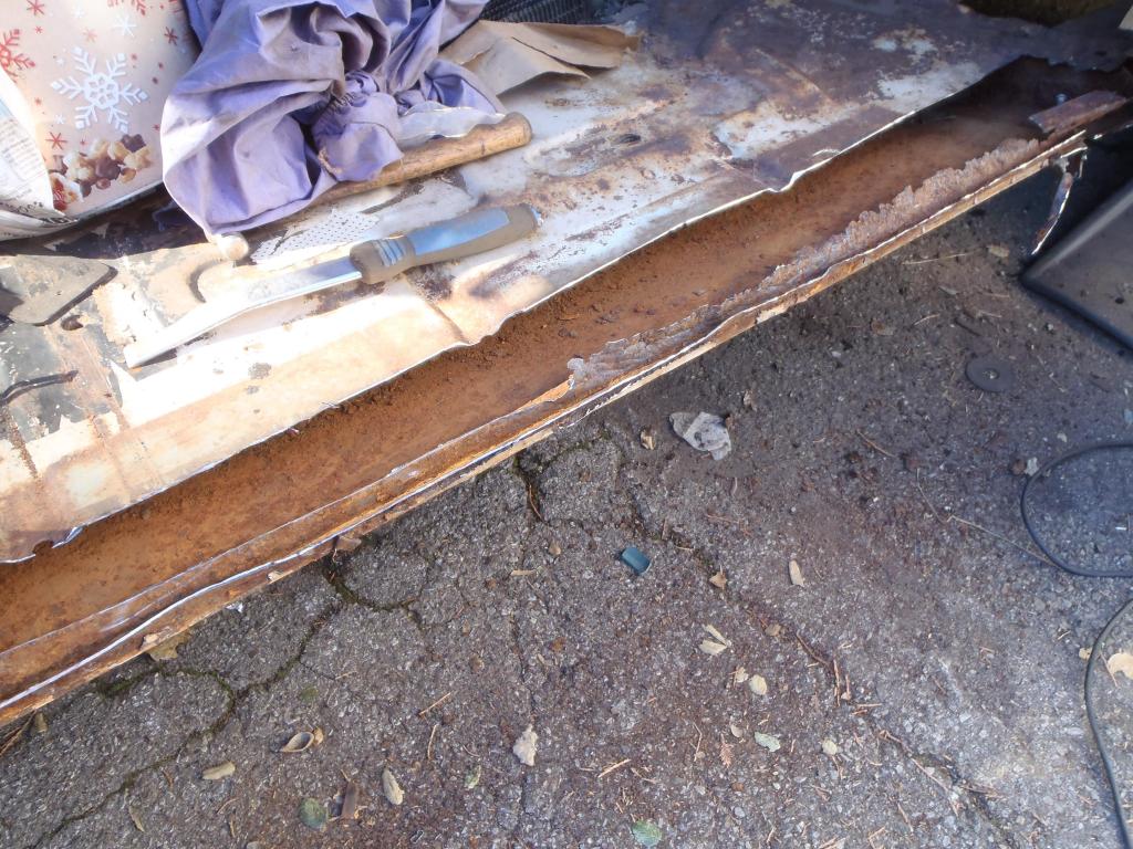

                              • I cleaned up the old bits of sill plate.
                                Click image for larger version  Name:	P3030855.JPG Views:	0 Size:	122.7 KB ID:	1883340
                                Click image for larger version  Name:	P3030865.JPG Views:	0 Size:	140.2 KB ID:	1883341
                                Click image for larger version  Name:	P3030866.JPG Views:	0 Size:	69.7 KB ID:	1883342
                                Ok, this is one of those times my wife is wondering what I'm doing staring at this for half an hour. The part of the floor that goes under the hinge pocket is rotted out to non existent. I'll probably cut off the new piece I already welded on and add a longer piece underneath the pocket and then re-weld to the new floor.

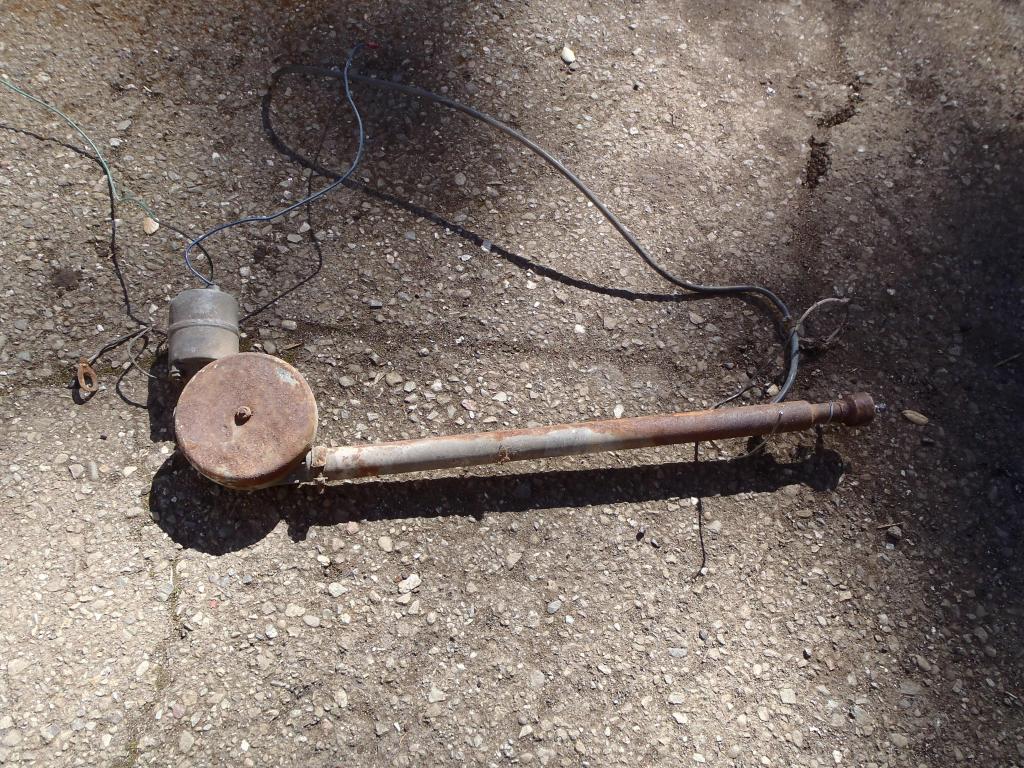

                                While I was there, I wanted to remove this old power antenna. it took two days.
