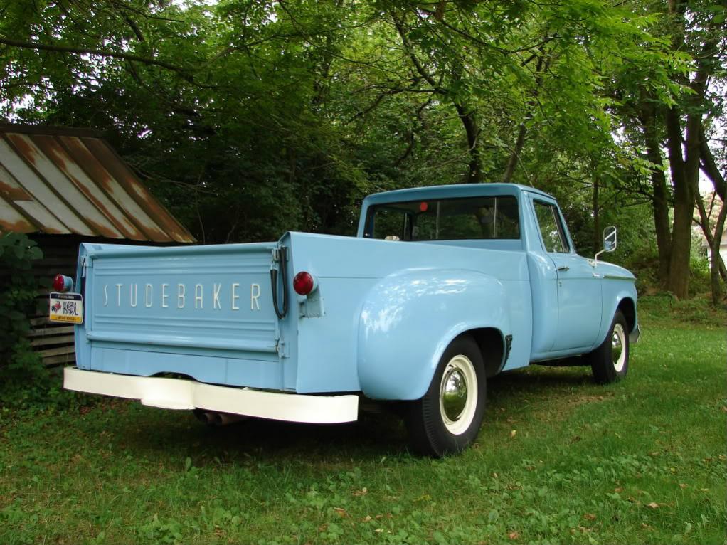

                        Here is a rear end that might have gotten it right - and it is a '61 to boot.
                        Wonder if the listing for the 7/8E rear chrome bumpers are the leftovers from the C-cabs.
