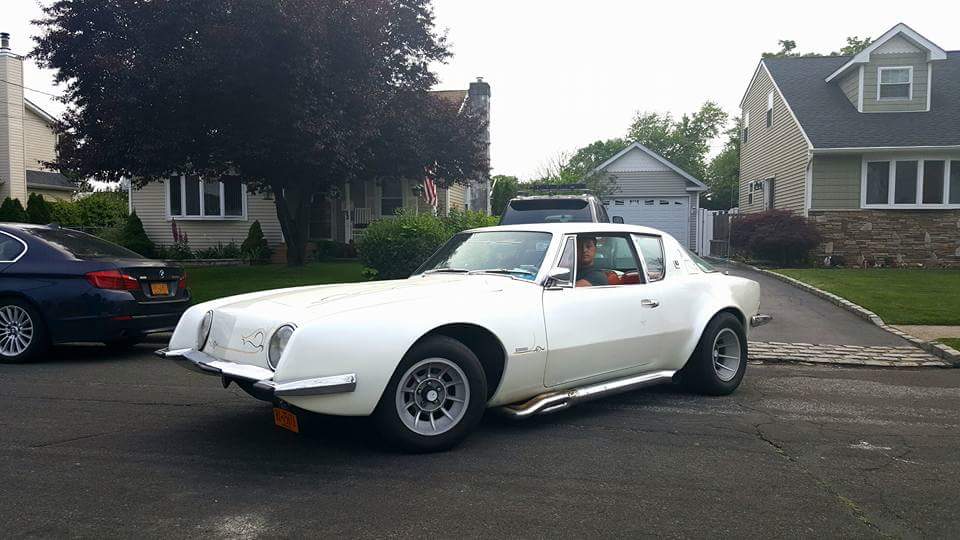

ID:	1707110 As you can see its not really stock anymore. My father removed the marker lights and the reverse lights and made his own wheel flares that mimic the original openings.

                      Originally posted by Endl98 View Post
                      [ATTACH=CONFIG]55082[/ATTACH] As you can see its not really stock anymore. My father removed the marker lights and the reverse lights and made his own wheel flares that mimic the original openings.
                      The Avanti is really cool. Great 80s vibe goin on with this car. A lot of older Vette flavor in this package. Very nice.
                      sals54
                        actually sals54 , My father did this in 1973. pearl white, has ghost pinstriping, pastel freak spots the flares and side pipes. plus 32 coats of clear. Its like a 1/4 thick. sadly the lacquer paint is starting to crack all by the fuel cap and down, the car has been garaged for 27 years I graduated in 87 parked it and I moved to Long island from Houston. Never really went back. My dad didn't drive it again, I just pulled it out of the garage 2 years ago when he passed away. Dropped a battery in poured gas down the carb, and it fired up in 20 secs. put all the fluids back in and been driving since.
