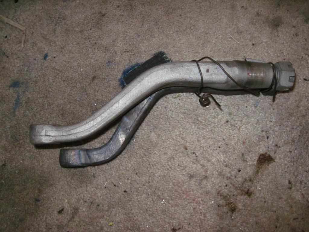

    Here is my "fine tuned" steering arm, under a stock one to show the difference. funny I didn't take any pics of the modified one alone. Click image for larger version  Name:	image_72472.jpg Views:	4 Size:	123.8 KB ID:	1806653

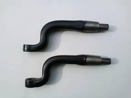

    This is the Avanti one.
    Click image for larger versionName:	quick steering arm.JPGViews:	0Size:	8.1 KBID:	1806654

  • Noxnabaker
    replied
    Would be nice with pictures of these shortenings I think...
    Please, if there are any..?

  • bensherb
    replied
    Originally posted by Jerry Forrester View Post
    Not really. To shorten my bell crank it cost me zero, zilch, nada dinero. Avanti arms sell for over $100 pr. I'd have to work for at least two weeks to make that kind of money. People tend to pay me what I'm worth, not what I think I'm worth.
    You sound like me Jerry! I just grabbed a torch and "fine tuned" my steering arms, I didn't want them as short as the Avanti units. Also cost zip, zero, zilch, nada dinero.

  • Roger L.
    replied
    I replaced the stock steering arms with the shorter Avanti arms that SI sells on my GT Hawk. Made a big difference and I'm sure it was easier than shortening the belcrank.
