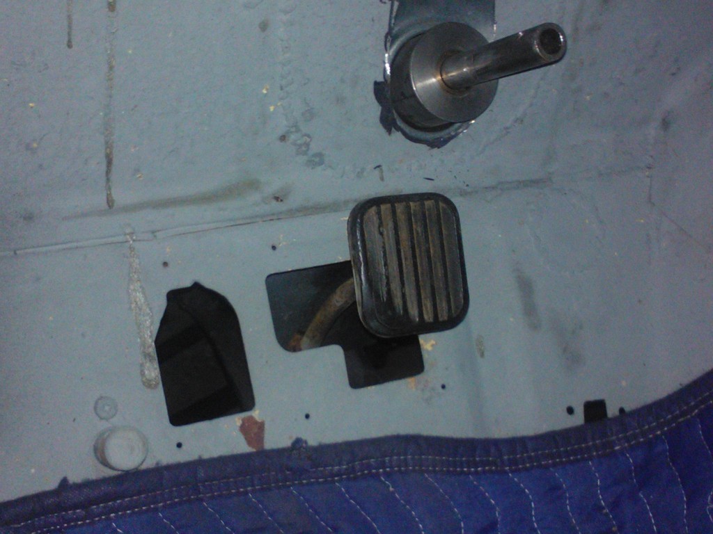

  • Jerry Forrester
    replied
    Originally posted by 345 DeSoto View Post
    [ATTACH=CONFIG]70451[/ATTACH]
    Jerry - Where did you get the round piece, in the fire wall, that the steering shaft is going through?...
    The outer shell is the original mast jacket. I machined the solid steel insert and pressed an oilite bushing into it.
    Leave a comment:
  • 345 DeSoto
    replied

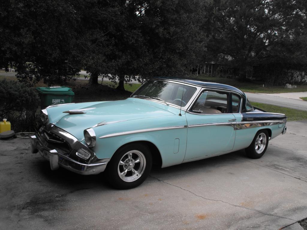

  • colt45sa
    replied
    Originally posted by karterfred88 View Post
    Yes, if we didn't have Studebakers, Haven't found an acceptable rack conversion yet, either hydraulic or electric--a center steer unit like a Chrysler or GM j car is a marginal way to do it, if you don't mind losing your Ackerman. The distance at the back of the cross member between control arm mounts is so small it doesn't leave enough room to get 6 plus inches of travel, and clear the oil pan at the same time. If someone uses an electric rack with center steer I might try it. Looked into a used Ford Taurus police rack (rear steer to get the rack motion correct) and using a traveling bar, but won't fit. Oh well, just have to live with the Bendix bag of snakes for now.
    Why not go 'balls to the wall' and install a Fat Man front clip? You can pick up five improvements at once, disk brakes, modern control arms, ball joints, rack 'n pinion steering (poweer or non-power), and correct Ackerman~!
    Leave a comment:
  • colt45sa
    replied
    Originally posted by Jerry Forrester View Post
    That's one reason I'm doing it. Who needs power assist over 15 miles per hour.
    Now I'm starting to sound like another guy on this forum that thinks anyone that wants more that 175 HP must be crazy. Why would anyone need a car that would run more than 60 MPH. <G>
    You're exactly right Jerry~! Driving my '55 President coupe down the road was never a problem. Parking, getting in and out of the driveway, and maneuvering in small spaces was agony. Other than lack of power steering and a/c that 67,000 mile car was my favorite of all the classics I've owned over the years. Regarding HP, the 259 V-8 with a properly tuned WCFB was more than adequate. Floor boarding it at 45mph when the secondaries opened was surprisingly strong. The mega-HP engines being produced today are downright stupid, unless you have a powerful desire to lose you license. Back in the late '50's and '60's when you didn't see a cop every 3 minutes, we might have been able to enjoy something like that on rare occasions.
