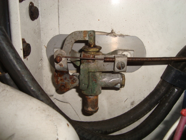

              • google ranco heater valve. There are numerous sites with a lot of information.
                The valve is very basic, not much to restore beyond replacing the rubber disc.
                BEWARE the bellows.
                It is thin and fragile. DO NOT puncture it. Whatever gas is in there stinks to high heaven, and will stay in your nostrils for days.
                Work in a ventilated space just in case, I didn't.
                Break the bellows and you have to find another valve assembly.
                The assembly is available at S I
                South Lompoc Studebaker
                • Originally posted by 55 56 PREZ 4D View Post
                  http://www.studebaker-info.org/tech/...b/rancotb.html
                  BEWARE the bellows.
                  Thanks for that link PREZ!! It gives a great explanation on disassembly and repair!!
                  I wonder if my valve has similar guts??:
ID:	1707587Click image for larger version
ID:	1707588Click image for larger version
                  I don't think there's a bellows in mine but until I take it apart I won't know....maybe someone else will recognize the one I have on my Silver Hawk?? I honestly don't know if it's working, leaking or what? I know that I had to lube the pivot points on those little arms, it was frozen solid and wouldn't move initially. Once I lubed the pivot points the valve moved up and down pretty easily. I guess I could connect the water lines and see what happens but I really didn't want to make a big mess under the hood with water/antifreeze if it happened to leak too much.
                  Luckily the few cold days of winter are very, very far away (like 6 months away) so I'm in no rush. My biggest concern is to get the defroster hooked up because where I live the front glass fogs up pretty quickly when the weather changes. We have such high humidity that you have to have a defroster (at least).
                  Treblig
