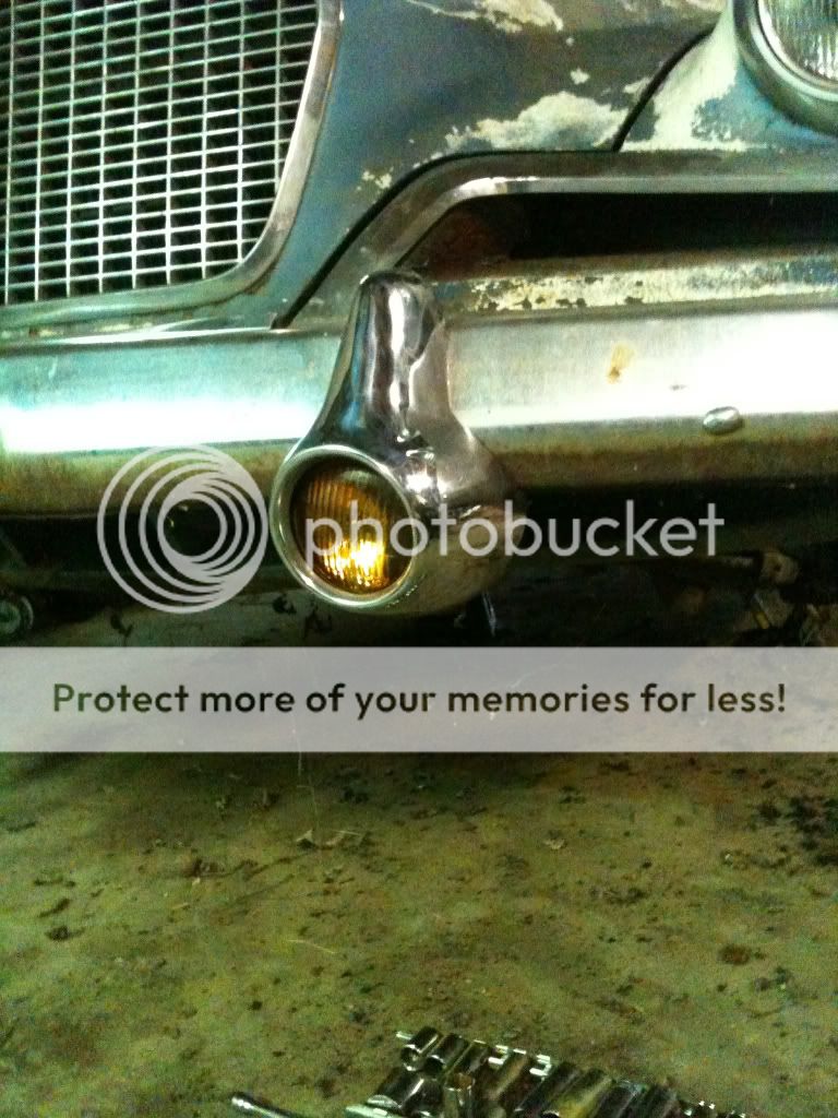

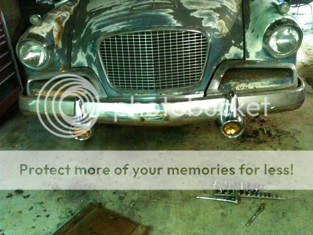

              Ok, so I made out to the shop and got 'em loosely mounted up, here ya go...

                They look like 1955 fog lights that would have six volt bulbs. Did you replace the bulbs with 12 volt units? It appears that the orientation of the bulb(s) is off kilter.
                  The fog lamps look nice on your Hawk.
                    I'm not sure if they're 6 volt or 12 volt, and it is the lenses that are off (I assume that you meant lense instead of bulb) because they're not secured to the housing. It was a quick bolt on job, I've already removed them and put them back up...

                      To: james.seagle,---- Looks like You've got a '55 bumper on that '56 Hawk. Where You mounted the 'fogs' is a '55 only location. Normally they would be mounted at the 'outer' hole. (factory install)
                      ( What I'm saying is: the '55 Studebaker front bumpers were the only ones to have that extra 'inner' hole )
                      This is interesting... Wonder if I have a '56 Bumper in the rafters of the shop... If not, anyone willing to trade my bumper for your '56 bumper?
                      Current projects: '56 Stude Power Hawk
                      Future projects: '56 Stude Sky Hawk ; '68 Buick Electra 225 ; '53 International R-110 P/U
                        To: james.seagle,-----Strike that.....brain cramp.......regular Hawk bumper guards would normally go where You put the 'fogs'...Sorry!
                          That would make sense... That's what I removed to put the lights on...

                            No, I did mean bulbs. Those 1955 fog lights used sealed beam bulbs, not lenses with bulbs behind them. You have to change the whole sealed beam unit to go from six volts to 12 volts.
                              That's how I mounted the fog lights on my '53 (though they and the '53- '54 bumpers are different from the '55s) and I like them even though I dislike cluttering the beautiful Starliner style.
