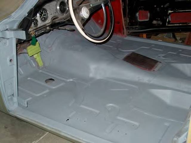

        I also used Classic Enterprises floor pans and foot wells; I only had to replace the front portions of the pan; My old rockers were still very good
        so I didn't remove them; I just set the new pans over my old rockers; I did have some trimming to do for both sides, so I spent
        a lot of time trial fitting.
        Joe D.

              Mike, the CE panels did not fit over the old ones exactly and also were a little higher, I guess because of a different bend. It did take some
              bending/cutting to get it close to the correct contours. Lots of work. I never did get them as low as the original pan but they're close enough.

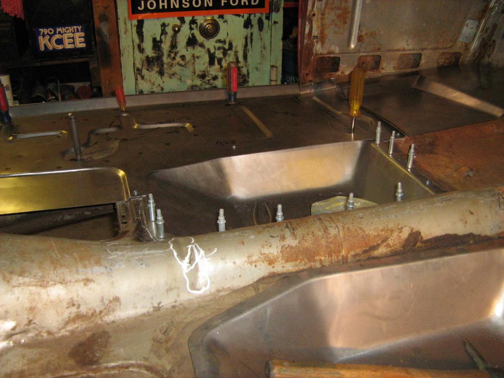

                                58 Hawk floor pan replacement
                                Passenger side floor using aligning floor body bolt holes,screwdrivers for main mounting bolt holes alignment the right rocker is good.Itrimmed 2'' off the edge of replacement panel.It will take you quite some time and many trys to et it to fit properly. Take a "little off "at a time and try the fitment again.D on't get ino a rush. It always is good to have more metal there to work with .on't be afraid to temp cut and bend back edges for a better fit later on. Even if you go to far and cut off to much metal,you can always 'add metal where you need it..later in case you goof up..
                                Left and right footpans with cleeko's trying to fit
                                Just a test to see how it works, more pics to follow
