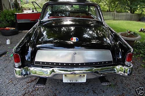

It is from a '62 or '63 GT Hawk, the holes are for the aluminum overlay panel.

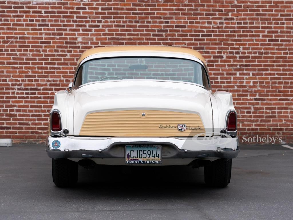

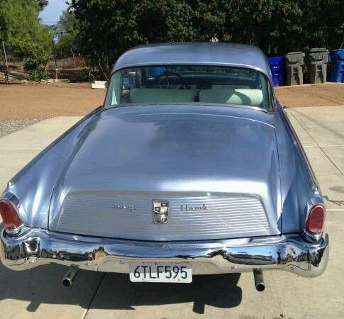

Here is a '56 Sky Hawk with the correct Decklid:
Here is a '56 Golden Hawk that someone figured out how to use a '57 Decklid on incorrectly. Correct ones have been VERY hard to find since about 1958 like the one-off '56 Hood:
