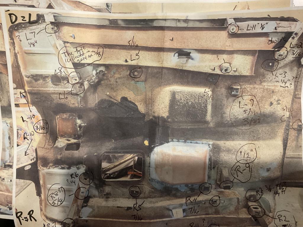

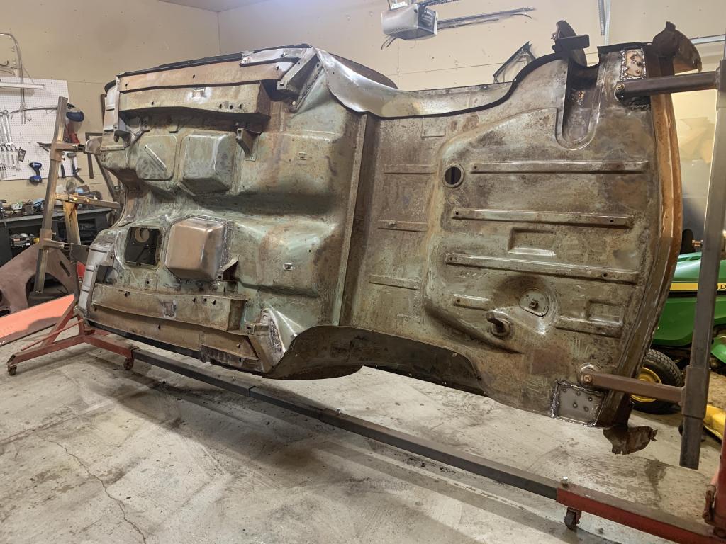

Body is out for sandblasting! Was going to buy new “set” of the reinforced rubber shims to mount body to the frame.
Does anyone have a cheaper source for these? Or suggest the proper material to buy and a way to make the bolt hole? I was kind of shocked to see $7-12 per spacer in the SI catalog. Lacking “old tires” to cut up, and thinking “just rubber” stock from Amazon is too squishy perhaps(?), wondering what you’ve used. (And a tool to punch that hole?)
THICKNESS?
Also, SI lists “Front”as 1/8”, while for “Rear” they don’t list a thickness. What would “Rear” be?

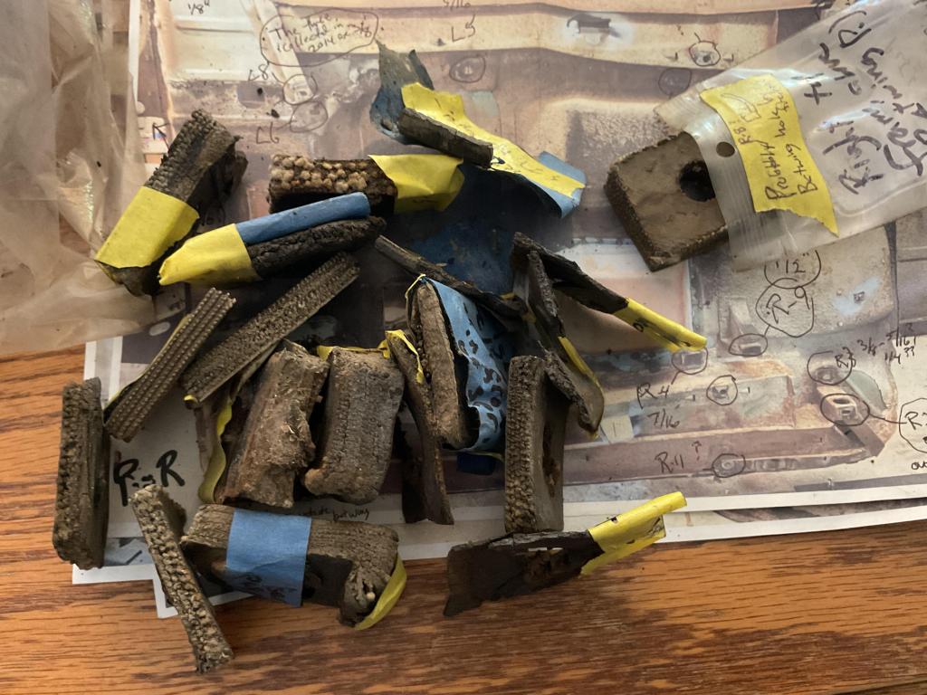

I salvaged most of mine, they range from 1/8” to 1/2” around the car. I have one at the ‘batwing’ that is 5/8”!!? …that one keeps the body from squishing the fuel lines, by the brake cylinder).
Does anyone know what these were originally to start with before years of compression? in my case, not many were as thin as 1/8”.
Yet I can’t believe the factory would have had more than a couple sizes, and every car went out the door with the same set? (Except maybe to shim for panel-gap fit?)
Thanks!
Barry
(oh, undercarriage cleaned up pretty good with blowtorch and air-chisel; thanks for whoever gave me that suggestion several years ago
