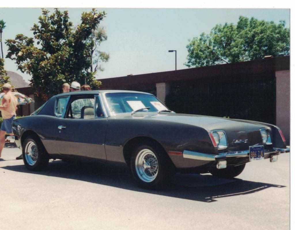

    I've been running Appliance Wire Wheels on my Avanti since the mid 80's. Prior to that I ran them on my "work" car for over 150,000 miles....they now have about 200,000 milClick image for larger version  Name:	2000-00-00a AOAI.jpg Views:	0 Size:	89.0 KB ID:	1887467les on them. Should I continue to run them?

    what no white walls? they look mighty fine, how's the engine,at 200k?

      Sorry, but I hate WWs on fancy rims. The car has just over 50,000 miles.....(I bought her new).

        I like the look of the wire spokes, AND the car. Not too many one owner Avantis out there. As far as the 200K on the wheels, if they balance fine, no slow leaks or vibrations, they must be fine.

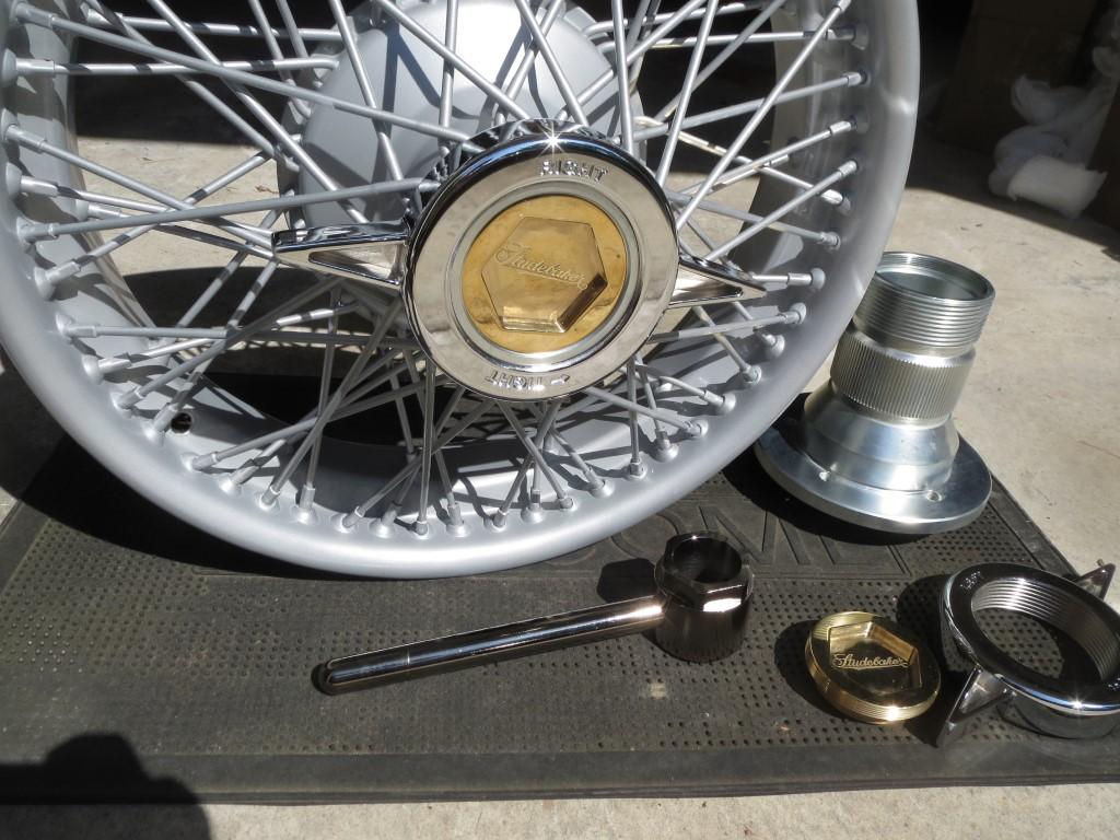

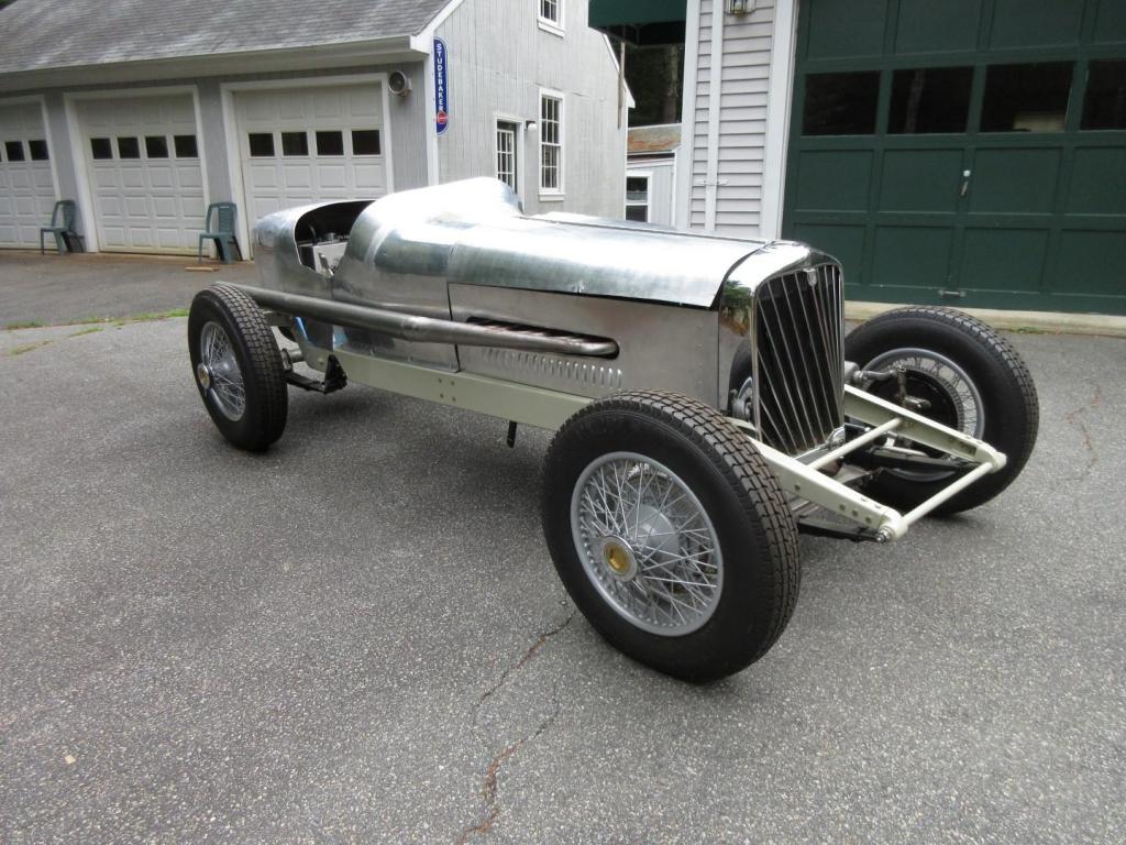

                        I got my Rudge-style true knockoff wire wheels from MWS in England, had custom hubs made to fit the spindles and bearings of my 1929 President front axle and 1928 Commander GB rear axle. The weight really does add up, especially with 7.00-18 tires, tubes, and rubber rim bands (to keep the tube from rubbing on the inside of the spoke nipples). Plus, the knockoff spinner and brass hub cap add more weight. The hubs are each 8 lbs of 4340 steel. The wheels are powder coated gray over electrophoretic coating. I expect they'll last many years. I did have to go to a special shop, New England Wheel Service in Auburn, MA, to have the tires mounted and balanced.

                          Absolutely beautiful, Gary! And worth whatever they cost.

                            Ditto what Jack said. Just. Wow!

                              So that's what you have been working on! I knew about it from posts but never saw a picture. Anyway it looks great Gary.
