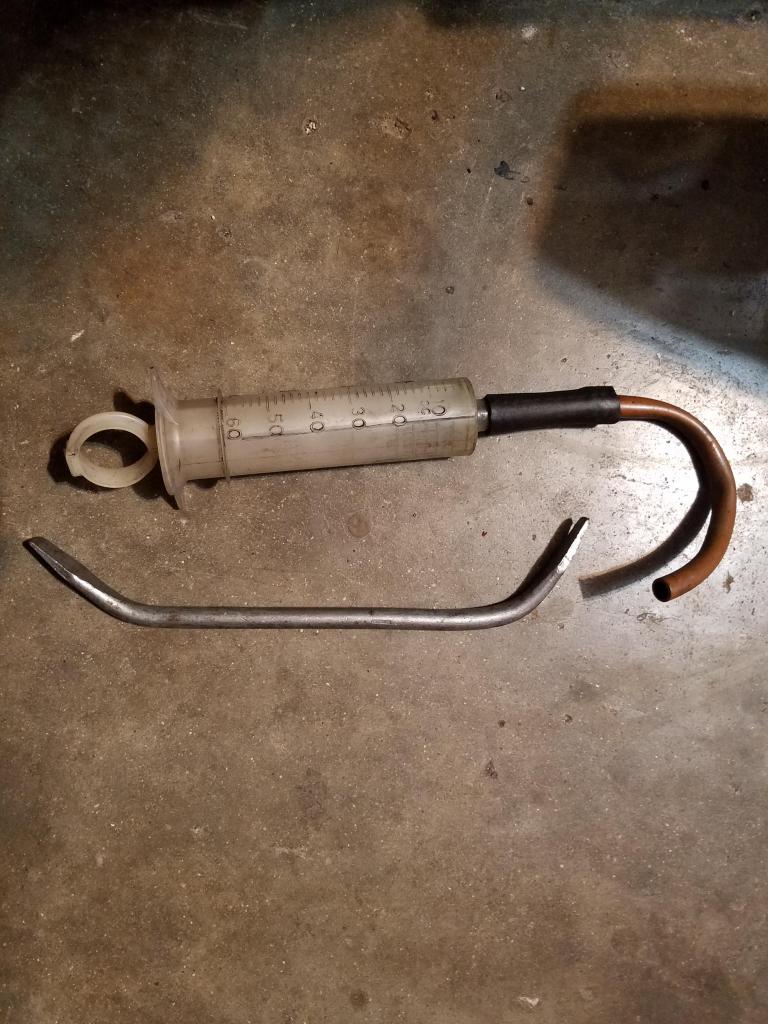

      Art, ASSuming you may be tempted to drive your GT awhile as is, before getting round to restoring the brakes, as discussed here, you wanna be sure the current tandem MC is full of fluid. As you mentioned, there's an access plate in the floorboard above the MC, and Turner recommence to cut an additional hole rearward for access to the rear reservoir. But that access plate is below the carpet, which must be untucked from below the sill plate to pull ups dn over to uncover the access plate, etc.. In short, it's a real PITA, and can be messy.
      For many years, I've been checking/adding fluid to the tandem MC from below the car. Use a large screwdriver with a slight angle bend (better yet, brake shoe adjusting spoon) to remove/reinstall the wire that holds the cover in place; slide the cover off, then use a finger tip as a dip stick to check fluid level (both reservoirs). If even 1/4" down, I top off. Use a 2 ounce plastic syringe, available in most FLAPS (Friendly Local Auto Parts Stores); attach a 2" length of 5/16"rubber hose on the tip, then slip a 5/16" copper line into the hose, about 4" long, bent into a 'U' shape. With syringe filled, slip the copper line into the reservoir and and squeeze the syringe to add fluid. You will develop a knack for filling the syringe by sticking the end of the copper line into a container of brake fluid. FIRST, you need to figure out which DOT fluid is currently in the car. Rather than reinvent the wheel, there are several excellent videos on line to review, explaining how to do that. Click image for larger version
