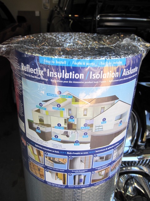

I am replacing the hood insulation blanket on my 63 Avanti. It is the fiberglass batting type and is a full blanket. The blanket is dirty and coming apart. I am replacing it with an insulating material used to wrap water heaters. It is a mylar faced material with honey-coned center. The material has a silver finish, but I am painting the engine side with black lacquer for a better appearance. I did this on another car and it worked well and looked nice. I'll post some photos when the job is finished.

Here are photos of the hood pad replacement on my 63 Avanti. I am pleased with the results, it will add some insulation and sound deadening. In addition it will be easy to clean. I think it is better looking than the old batted fiberglass. I was able to get the old pad off in one piece and used it as a pattern. I cut the area above the air cleaner bigger than the original pad's hole so the whole housing would in.
