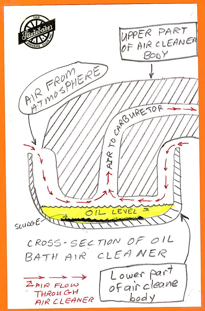

      Here's a diagram to illustrate how an oil bath air cleaner works; the principle is a good one but a bit difficult to understand.
      The theory is this (and it works): Dirt particles, being heavier than air, are what forces them to "keep going down," being thrust straight ahead into the oil bath where they are trapped, when they need to (but can't) make that sharp bend on top of the oil pool to go back up and enter the carburetor:
      As you see, if oil is touching any wire mesh (not shown in the drawing but present at the bottom of the air duct going back up to the carburetor), oil will be sucked up into the engine, making a terrible mess of blue smoke and oil-fouled spark plugs, until the level is low enough that it starts to function as an oil bath air cleaner is supposed to. BP
