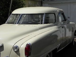

        The Starlight Coupe was a body style available in both the Commander and Champion Models (not Land Cruiser, which was strictly a stretched high end four door). The Starlight was a two-door five passenger coupe. From '47 through '52 it had the iconic rear turret wraparound windows, often thought of as the "quintessential" Studebaker.
