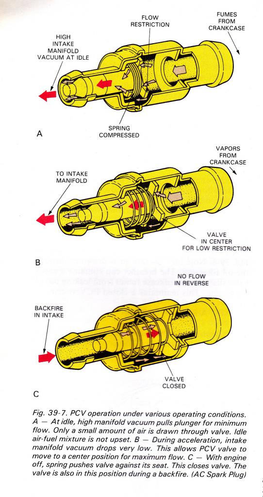

                              One thing I don't see mentioned.
                              The PCV system is a "part time" system..!
                              If you think a moment...the vacuum comes from the carburetor. When the engine is at idle, the PCV valve does the most work. As the throttle is opened, the vacuum goes down some, and the faster the throttle is opened, the faster the vacuum drops...equaling the the same amount the PCV does that much less...and does NOTHING at full throttle.
                              As has been noted though, the valve does "nothing"...for the way the engine runs. It just allows the intake system to pull vapors from the crankcase into the intake. While it does help the environment some, it actually hurts the engine performance. Oil vapor does not burn very well..!
                              If you want the best in crankcase ventilation, there is actually pumps you can buy to actually pull a full time vacuum in the crankcase. But these don't last long on the street..!
                              Also as has been noted, the various "breathers" work as the crankcase builds pressure, ALL the time. The stock road draft tube does a good job, rocker cover breathers do a fairly good job, the Avanti, oil pan breather does a good job. All of these work "all" of the time.
                              For those "green" folks...nothing really wrong with the PCV valve on a good running engine. But as the engine wears, the PCV system adds to the lack of power, and the fouled spark plugs.
                              Mike
                              • #30
                                The function of the PCV valve is often described this way -
                                idle, valve nearly closed for low flow despite high manifold vacuum. The idle mixture does need to be adjusted to compensate for the additional air coming in from either the air cleaner or oil filler vent, as there is Not much blowby at idle. Ventilates crankcase when the road draft tube would not be doing much good. Which does good things long term for engine life.
                                Accelerating - PCV wide open for maximum flow despite low manifold vacuum.
                                Cruising etc, somewhere in between.
