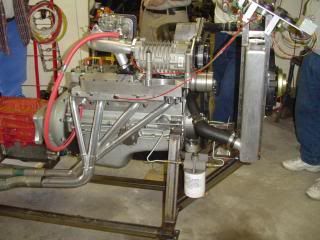

        Here's a picture of an intake manifold I made many moons ago for a flathead. This was part of a turbo project. As you can see, its not too difficult to fabricate something like this. It would be just as easy to do an exhaust header. If you want it to look extra nice, use some mandrel bent tubes directly off the flange. A collector can be purchased from most header suppliers or just cut one off an old Chevy header.

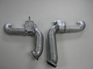

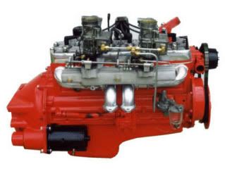

                  So you prefer the modified cast iron manifolds like these.
                  Instead of these.
                  I wish I could talk to someone who had successfully modified some cast manifolds. I have been thinking of giving it a try even though I currently don't have a Champion to use them on. I wondered if there was enough demand to give it a try.
