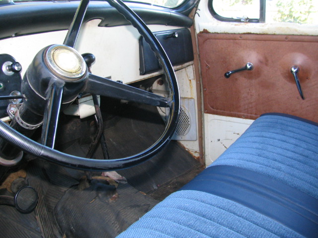

                  This is what I had done locally to my '62 Transtar 7E13 1 Ton Dually:
ID:	1690928 Click image for larger version
ID:	1690929 Click image for larger version
