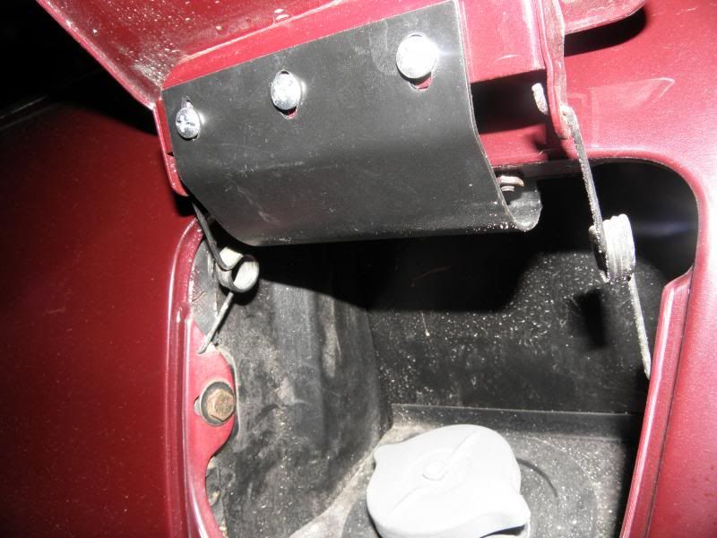

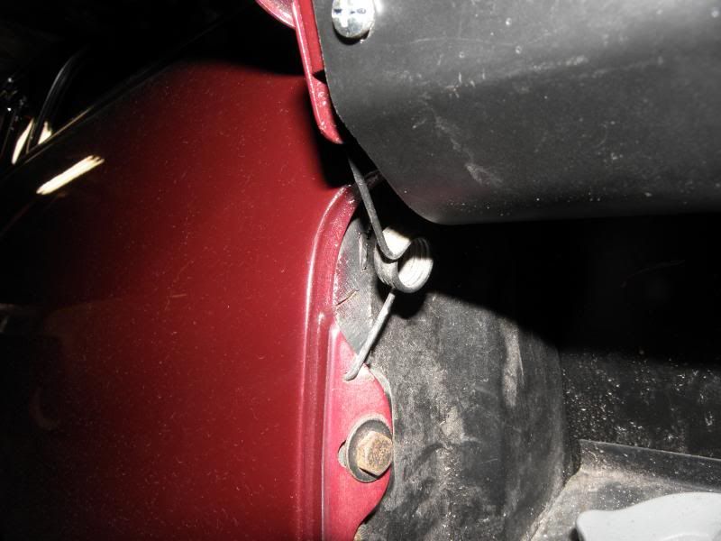

                  My favorite ploy; a few pictures.
                  Oops! That's not a fuel door!
