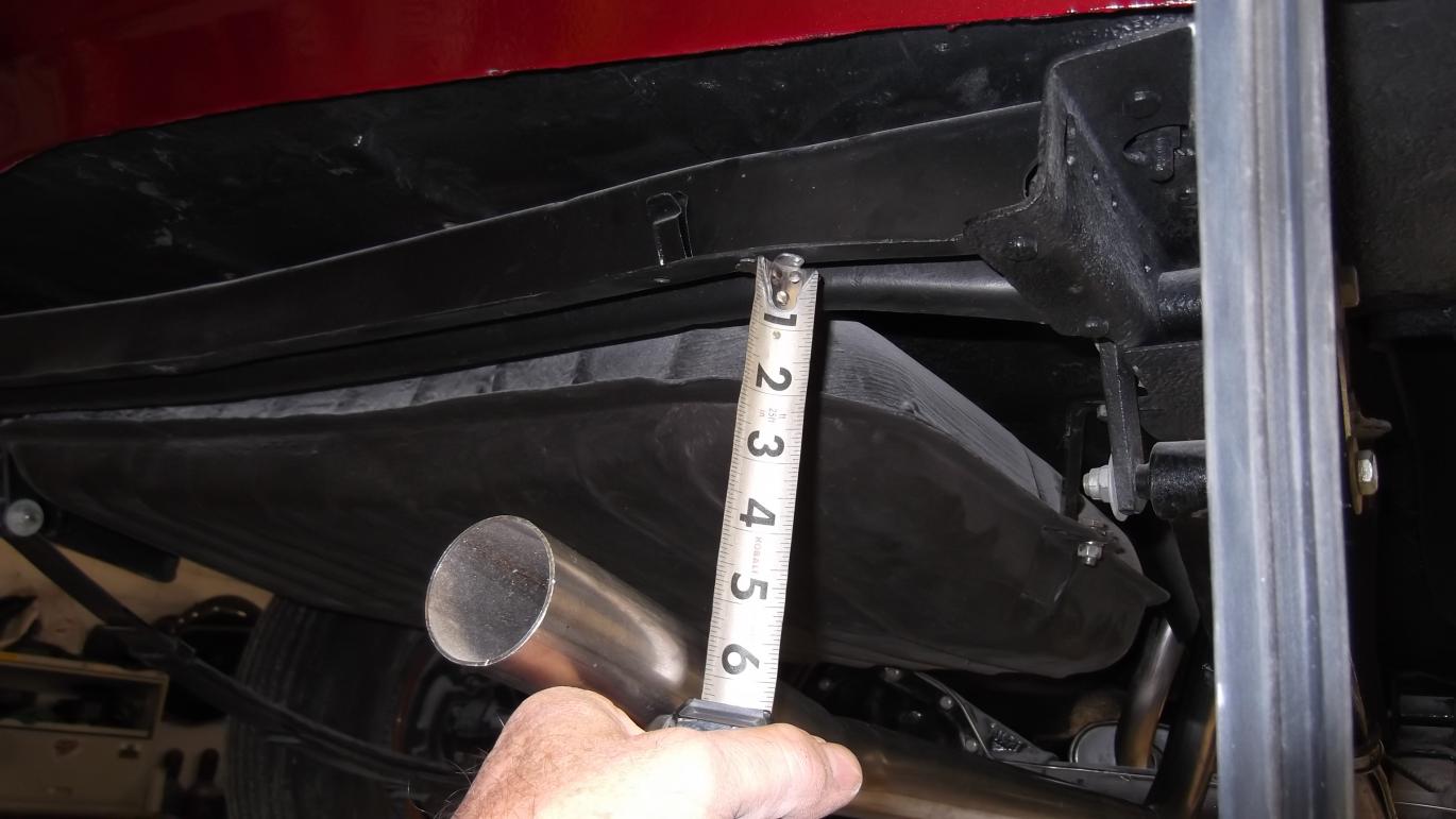

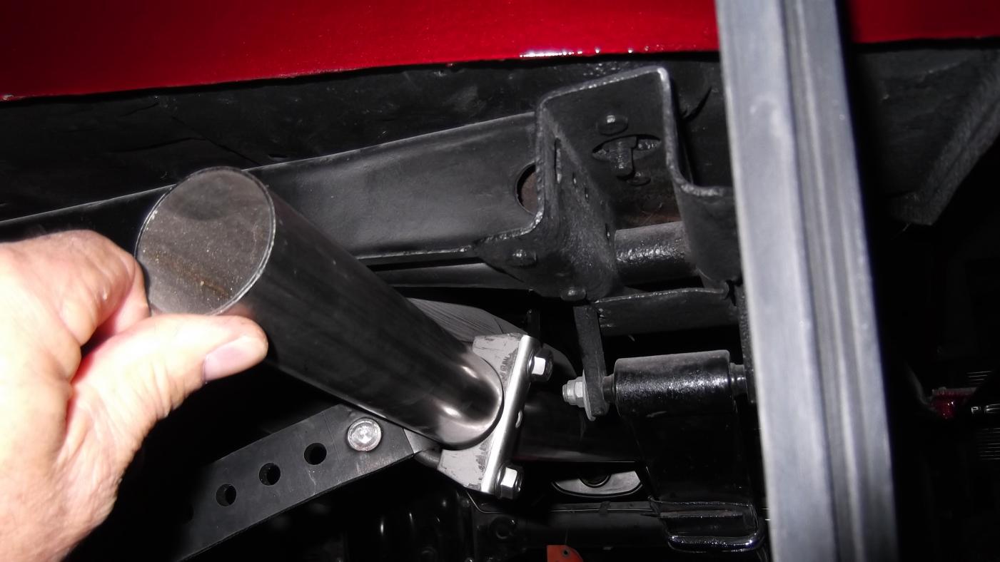

    We purchased a set of dual exhaust from Don for the 58 Packard Hawk and I am struggling trying to get the rear pipe that attaches to the muffler to fit properly. I have it running on the outside of the shock between it and the tire. When I try to move it up into position where I think it is made to fit, it leaves the tail way too low. I talked to Don this week end but can't get a hold of him now and he doesn't have e-mail. does anyone have measurements or pictures that might help?

    Regardless of anything else, Kerry, the tail pipe should run on the other side of the shock absorber, not between the shock absorber and the wheel. BP

        Bob, thanks for the reply, Don told me to run them on the outside of the shock.
        ?? I will move it inside and see what happens. --
        BINGO !!!!!!!!!!!!!!!!!!!!!!!!!!!!!
        I Think that has it now!!!!!!!

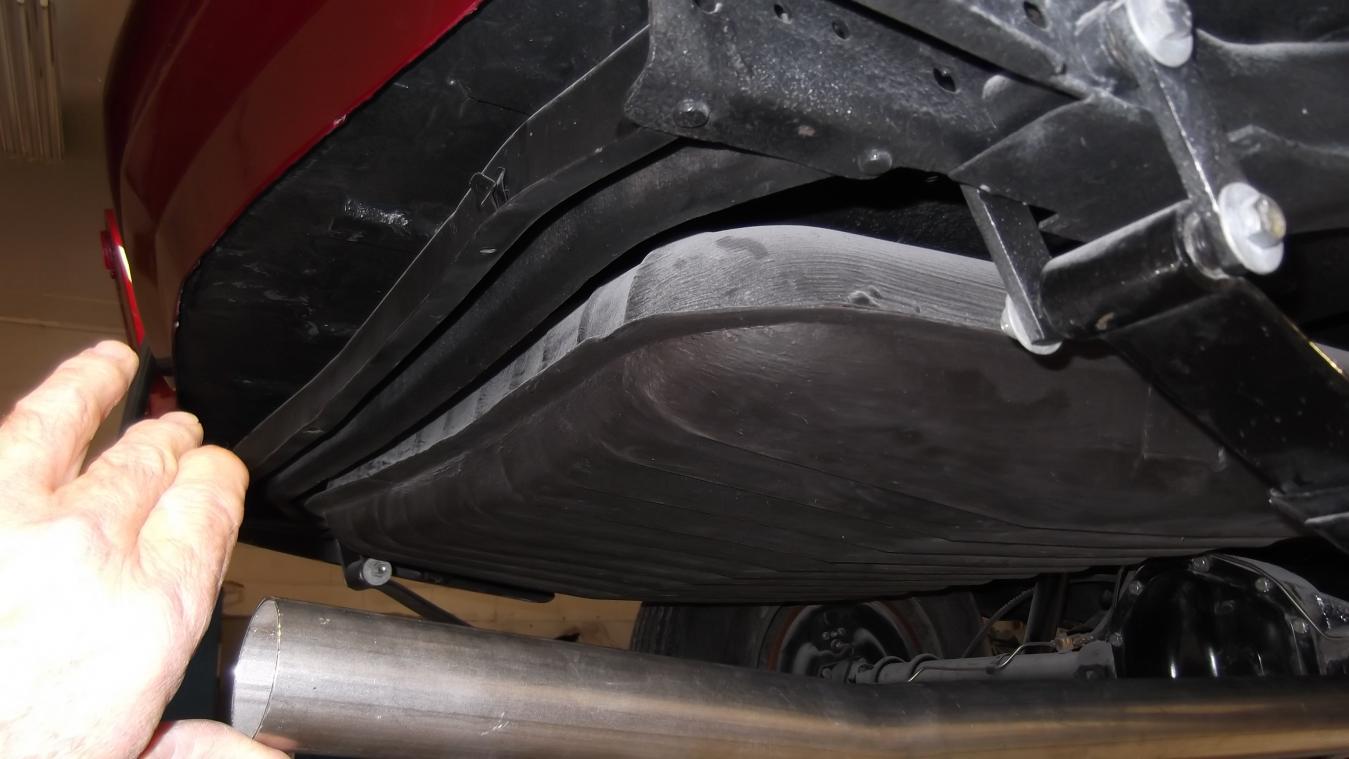

            Several things look wrong:
            (1) The Tailpipe goes inboard of the shock.
            (2) The Tailpipe routes between the Gas tank and the spring, from the pic angle it looks like it would not fit meaning the wrong gas tank.
            (3) The head pipe should come STRAIGHT down from the manifold, it's tipped outboard so it does not fit in the center of the crossmember "dip-up".
            I have never tried Don's pipes but if they fit exactly like the original factory pipes, they would be the FIRST repros in History to do so.
            It makes me wonder if the people that say they "fit fine" ever saw an original exhaust system.

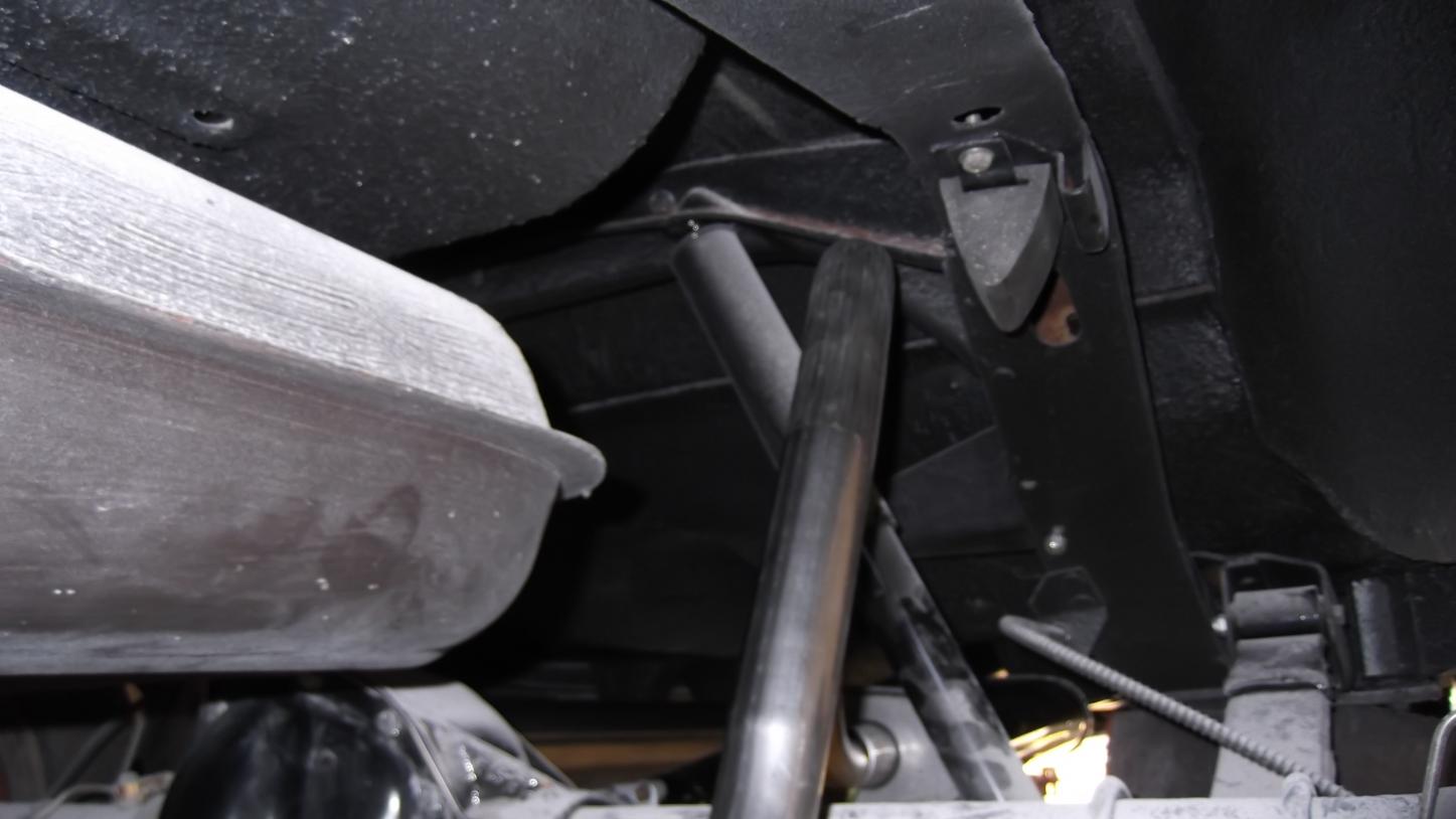

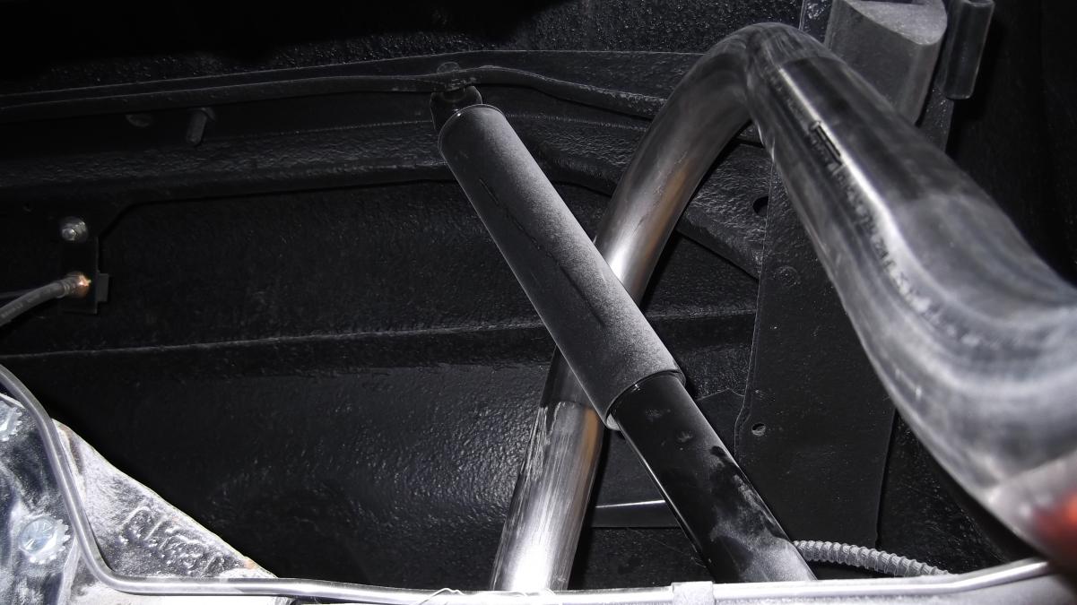

              New pictures with pipe running inboard of shock- Not tightened yet.
              The pipe is pretty much in the center of the "flip up" of the cross member and the end kicks up where it should. I will leave the tailpipe loose until I hang the bumper for fitment.

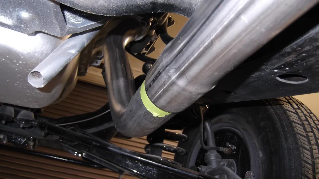

                  I spent most of the day yesterday fiddling with the drivers side exhaust and finally got it alright back to the muffler. However, just can not get the tail pipe to look close to the other side one and have decided to cut and splice to
                  make it travel the way it should. I left Don a message but no reply.

                      For pipe adjustments I preload the pipe where I'd like it to be ( or closer to where I'd like it to be) then use an oxy acetylene torch to heat a 2 inch X 2 inch section of a pipe red. Sometimes heating just the inside half of my intended bend is enough. Often have to do in and out. If clearance is tight then the accessible side gets heated. I generally slide some sheet steel behind the pipe where I'm working to protect the car or components. if you don't have an OA torch a Mapp gas torch might work, although the "new" Mapp gas seems a weak cousin compared to my recollection of the original stuff.
                      If you are uncomfortable with fire, cutting the pipe in a strategic straight section and adding a larger pipe to form a clamped slip connection adds a few degrees of adjustable wiggle.
                      I have not had much luck "adjusting" exhaust pipes using the same techniques that work so well on thicker steel.

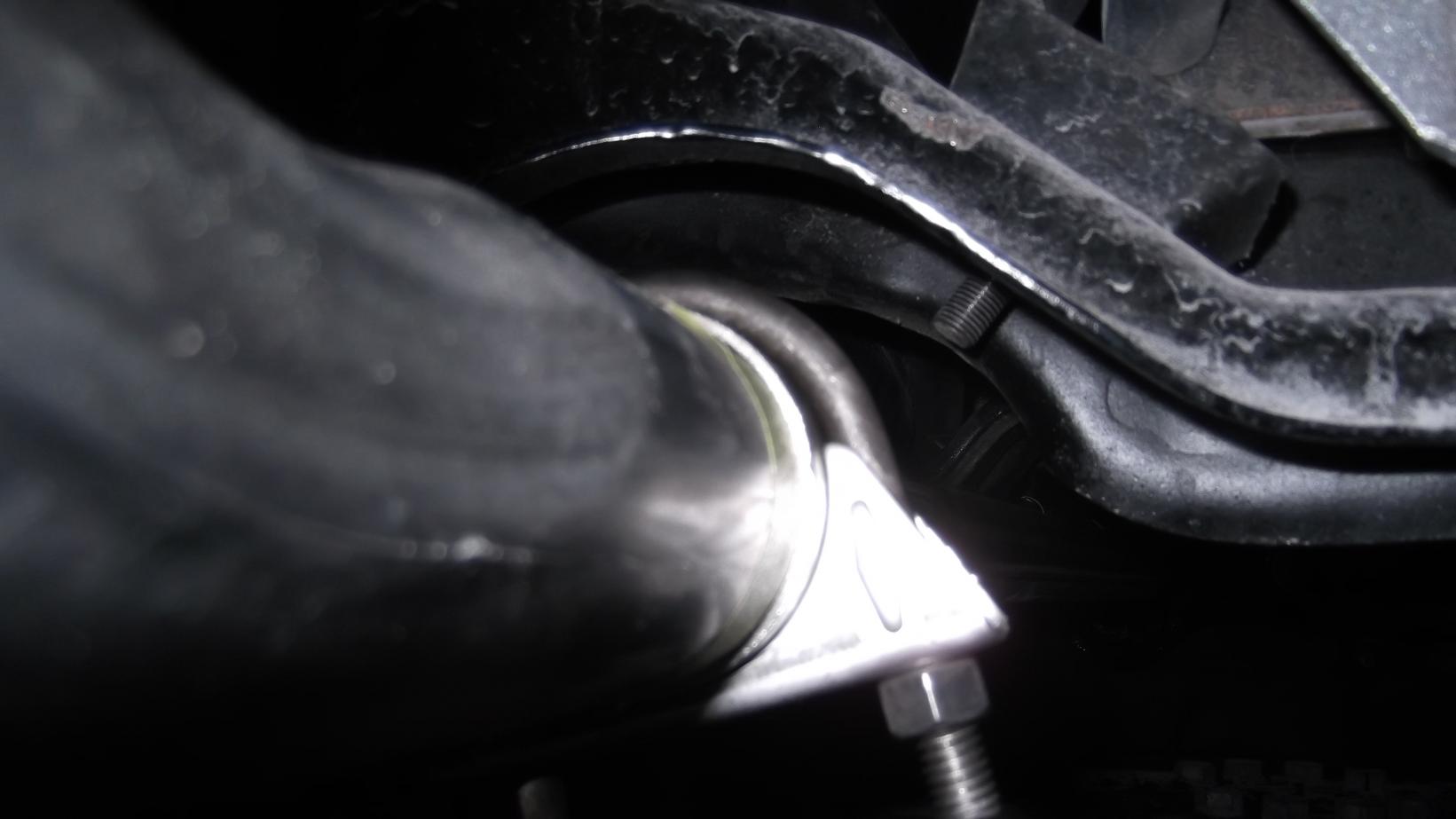

                        In your Post #7, pic. #3 shows incorrect tailpipe attaching hardware. IF ...the correct hardware (the parts Studebaker designed to fit that specific location) were used, you can pretty much move the end where you want it to be ...then tighten the clamp and it should stay right in that position.

                          I will cut the rubber portion of the hanger to achieve desired location. Those are what comes with the kit.
