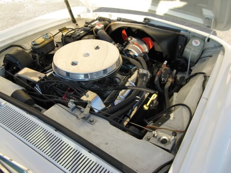

    How do you guys feel about addative repairs? My Avanti has a small leak at the very bottom drivers side of the rad. Don't really know if it's worth pulling the whole radiator out and don't know that it can. Be repaired without removing. Is there any downside (other than maybe not being permanent solution) to useing the addative type sealers?

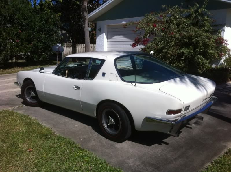

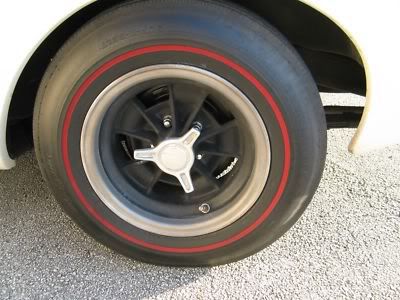

          I just bought it I'll get it to a radiator shop next week, just wanted to drjve it over the weekend without it leaking all over. It will be my signature pic soon 63 R4 clone (all NOS components) machined to R4 specs original 7" wide Avanti halibrands.

            I think I just drooled on my computer monitor a little bit....
            Nice Avanti!!

                I remember riding in the back seat of that car when I was 14 or so. I used to think it was one of the coolest Avantis I'd ever seen.
                I still think that, but I used to, too.
                  I do to think its one of the coolest looking avantis I'm typically not a huge Avanti fan. Don't get me wrong I dig them but never really found one that made me pull the trigger on till this one. The wheels man the wheels just make it scream cool. The paint is original and I'm gonna keep it that way for a while.
