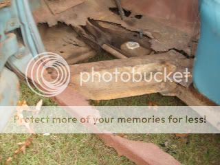

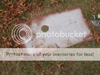

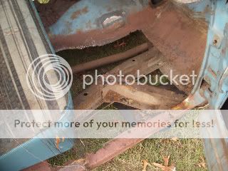

      This is what the po had on the drivers side floor.It was just screwed down with some sheet metal screws and then he covered the whole floor up with a black mat
      [img][/img]
      This is what I found when I brought the car home and took out what he had put in
      [img][/img]
      This is the drivers side and it is almost totally gone
      [img][/img]
      I'm gonna have to weld in all new door seals,floor pans,everything.This is why I've gotta make my own.
      • #18
        The picture displays why you should just buy the ones from Classic or Leroy Carey if Leroy does make pans for a Lark. Classic pans include the threshold. You have nothing there to go by even if you are to make them yourself. Do you have factory blueprints or another car to make patterns from. Pretty hard finding someone that has a car in that rough shape wanting to make it road worthy. We should be saving the better shape cars out ther lest they become like yours. Buy a better car and use that one for parts. You may not like reading this but it is the truth. Better cars are not hard to find and can be had for cheap. Take a drink of water. You'll wish you had after you jump into that. jimmijim jimmijim

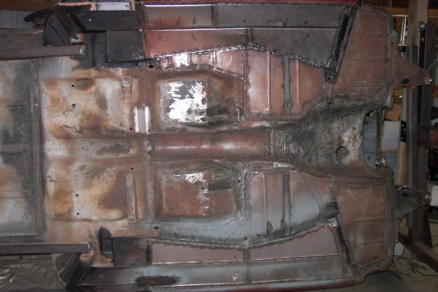

                      Now that you have decided to go ahead with you floor project, here is a shot of the underside of the 54K that I did with sheets of 18 ga steel and a home made bead roller and a cheap 24" HF medal brake. If you can't roll beads than you can form them or tack weld small metal angles to stop oil canning.
                      Forge ahead fearlessly, it's only metal. Just remember to stabilize the door jamb area so the doors will fit first.
                      Bob
                      • #26
                        Nice work, Bob!
                        I don't own a bead roller, but I have an old home-made brake that does what I need it to do. I save a lot of scrap metal that already has pressed-in ribs, etc., and cut the the scraps to match existing floor ribs. I posted pics of a Wagonaire floor to which I did this about a year ago.
                        Another useful thing: find a sheet metal shop that will brake up a few lengths of "hat channel" for you. Hat channel is sheet steel formed into a rectangular trough about 3/4" deep by 1 1/2" wide, with flanges about 3/8" wide on both sides. In profile, it looks like a flat-brim hat, hence the name.
                        Weasel bodies were built using a lot of this stuff. You can cut it straight, or on a bevel with a saw or snips, punch holes in the flanges, and plug-weld it to the underside of a panel that needs stiffening. It's a huge time-saver to have a supply on hand, even if you have the tools to fabricate your own.
