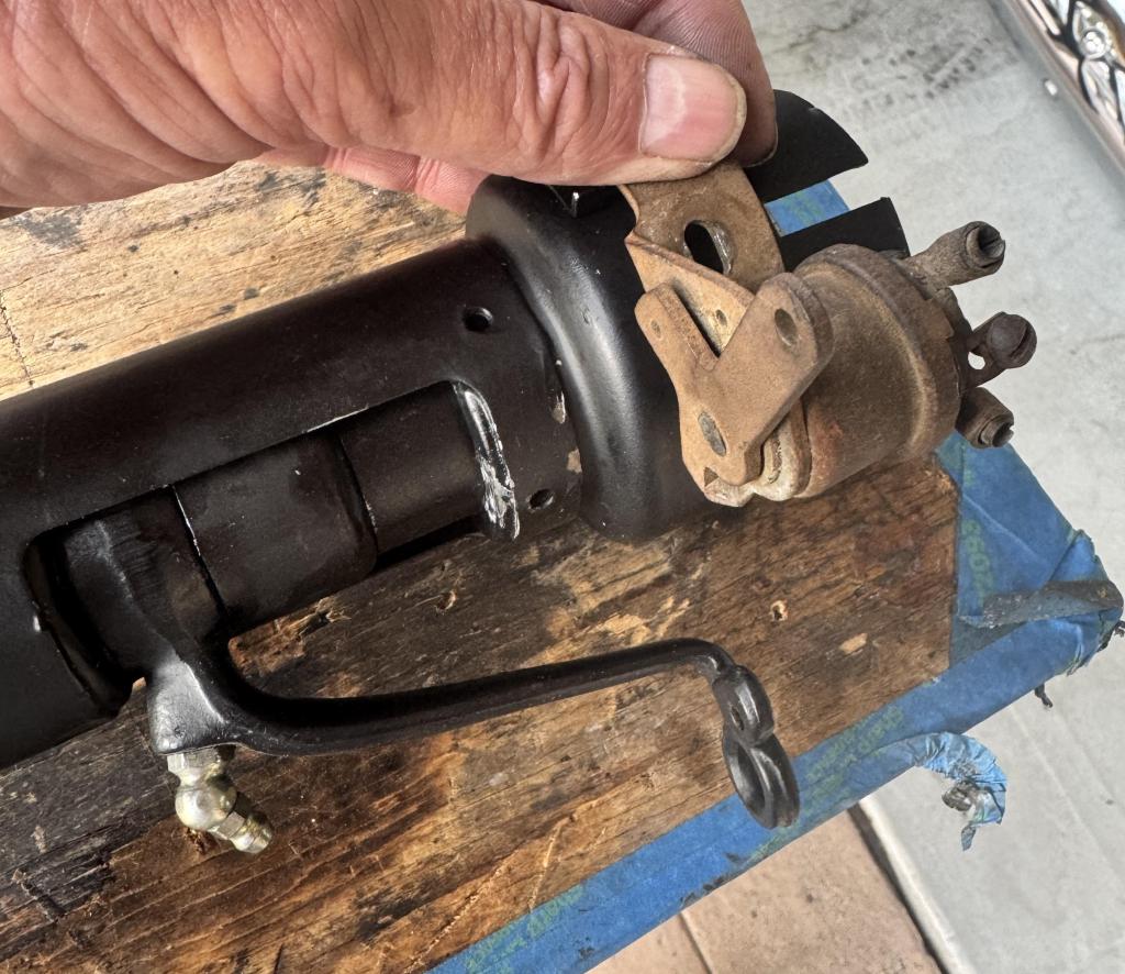

    I’m looking for a picture of what a start lockout/backup light switch for a power steering column on a 53 or newer C/K.
    I have manual steering switch and I am looking to see just how different a power steering switch would be.
    Thanks, John
    I am sure it is all about the way the linkage and lever are made to fit a different column, ANY way you can rig it to the shift lever that puts the switch all the way left and right, to make the circuit for Back-up Lts. and Neutral/Park at the opposite end of travel will work, if you can't find the correct switch.
      Yes, I have been looking how to make my switch work. A little metal, a little welding and it can be done. I was just curious what it would/should look like.
      Maybe I'll post a want ad to see if someone out there has one that they are willing to sell.
        As for any of the later cars which had Bendix power steering, they would use the same switch regardless of power steering or not. They used the same steering column and box for both.
          That would be correct, but I'm installing a Saginaw system, so my column has to change. I guess I should have asked for a picture of a Saginaw switch. Hoping someone out there can snap a quick photo and post it.

            If the switch is like this(image below) I have one in my 3 speed manual, I can take a picture of it.
              If it is saginaw power steering that would be great. Otherwise, thank you for the offer but no need, spend your day having some fun.
                I'm really not sure if it is the Bendix or Saginaw this is on my 57 Commander I couldn't see a brand name on the power steering reservoir.

                  You have a complete Saginaw Power Steering System, it is integral in the Steering Gear, having only Two components, not like a '58 to '66 Bendix/Eaton with Four and 4 Hoses.
                • StudeRich
                  StudeRich commented
                  Editing a comment
                  It appears that with Saginaw Power Steering the switch mounts on the Steering Gear, not on the Column like the one shown for a non-power, Car.
                  The function is the same, but with Automatic there are 4 wire Terminals and Two functions, in P&N & R positions.
                  The Photo is of one for Automatic.

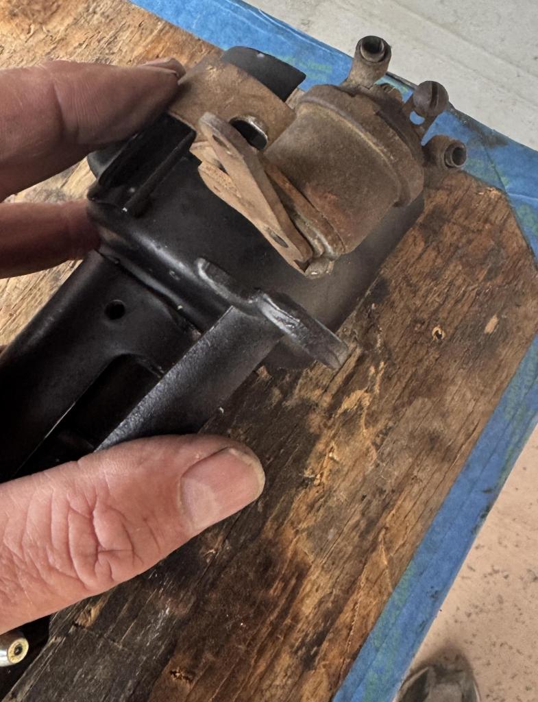

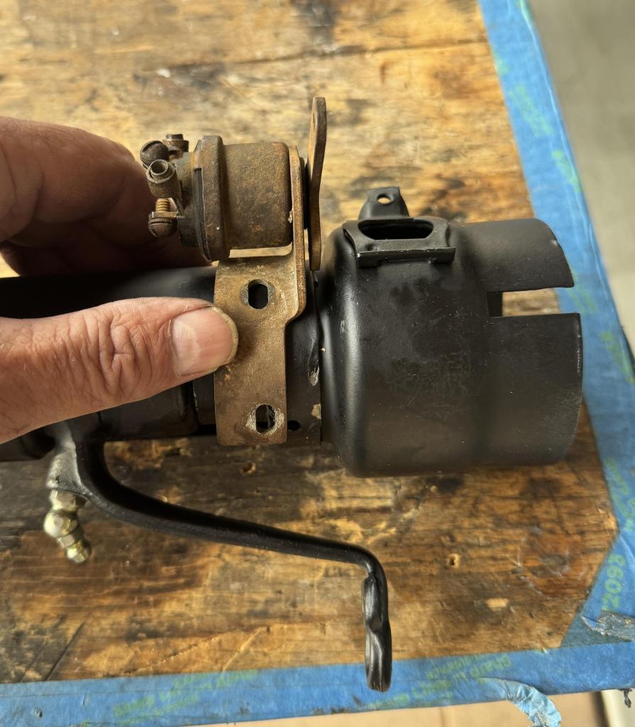

                  Sorry, didn't read his original post very well, right pump wrong transmission and linkage. Good luck guys, sorry I couldn't help.
                Sasquatch, thanks that second photo shows the bracket going up the column to the mount holes. That was unexpected, my guess would have put the switch on the upper side of the shift lever. I’ll have to rethink my adapter. Click image for larger version

                • StudeRich
                  StudeRich commented
                  Editing a comment
                  The clue is usually the mounting holes. Whenever an optional Part that MAY have been ordered was designed, the factory usually put the holes in place in case they were needed.
                • Desert53Stude
                  Desert53Stude commented
                  Editing a comment
                  I thought that they may have bent the mounting plate to install like the last picture. But now I realize getting to those wires would have been a PIA. So over the bell they went.
