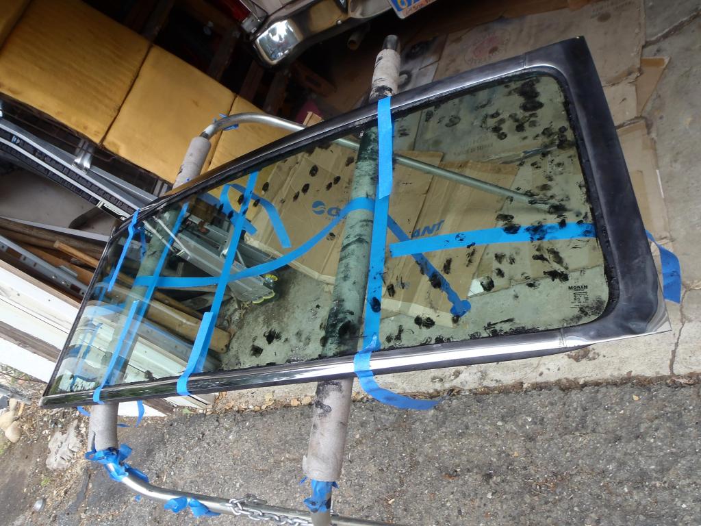

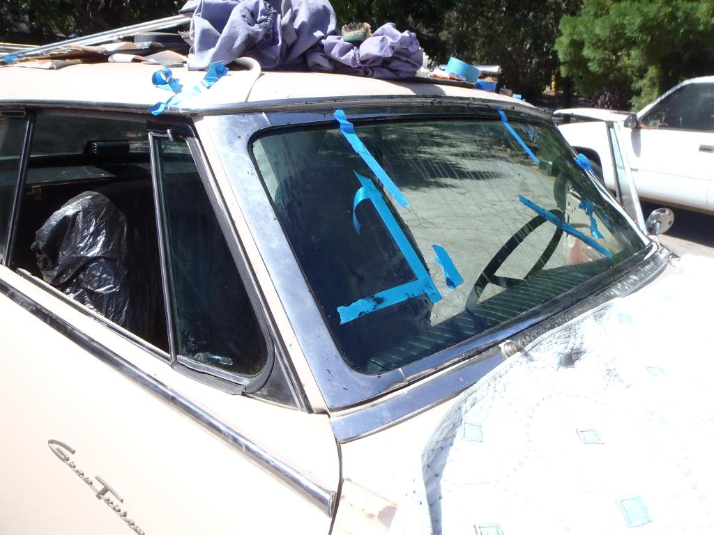

I am buttoning up my total restoration on the 54 Starlight, Looks like I will be installing the windshield with a helper. I read the process outlined in the factory manual and understand it. My retired mechanic (he drives a 53) swears I should not glue my new gasket to the glass and I should avoid using a butyl cord of sealant in the exterior flange. He also insisted I put the chrome in after the glass is fully installed. On my trial runs on my work bench I have gotten up to 3 pcs of chrome fitted in the new rubber gasket on the glass as it lays on my work bench, but on the 4th piece of chrome my rubber gasket has popped out of place, I have my blue masking tape out trying to keep all in place, the soapy water I'm using to help with the insertion of the chrome strips weakens my blue tape, come to my 4th pcs of chrome my gasket pops off the glass. Not one of our longtime glass shops here in Tyler Texas will install it. Should I lay a small bead of butyl sealant from CRL in the gasket and tape the gasket so it is held against the glass edge of the winshield and let it cure/dry, before I set the chrome strips in ?? All and any advice is really appreciated. I HAVE NEVER INSTALLED a windsheild.
