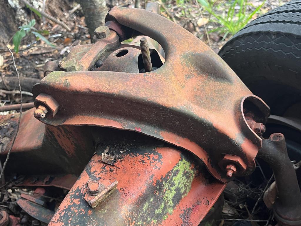

The rubber bushings were only used on 1953 and later cars, simply because they were cheap to produce... 1952 models and earlier, back to the mid 1930's when the Planer suspension debuted, use steel bushings on steel pins. All of those cars rode pretty smooth. I don't see how Delrin bushings would cause problems if steel bushings don't.
Upper arm on a '51 Commander:
- Likes 1
