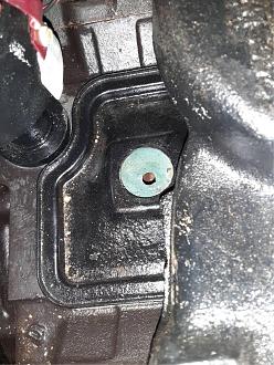

    Is it possible to replace the road draft tube with a PCV here? I'll be using an Edelbroken 1406 carb. Thanks!

    There was an adapter for the road draft in 62. I may still have one. Will post pix tomorrow.

      The Lifter Cover ADAPTER , PCV 3/8" Hose and PCV Valve were Used on '62 and '63 V8's and possibly some '61's shipped to NY or Calif. possibly more States.
      Also 2 Brl. Stromberg Model WW Carb. with a Base with a Vacuum Tube at the rear for the 3/8" Hose.
      The 1964 V8's had a Special Lifter Cover without the Large draft Tube Hole, but with a welded in Fitting to fit a screw-in threaded Carter PCV Valve that flows TO the Carb..
    You could also try to procure Avanti or JT set up.

      If you put a PCV valve there, without a valley pan, the PVC will suck up oil that is plashing around in the valley. If you put a riser there, and put some coarse steel wool in the riser tube, that will greatly reduce the oil getting sucked up.

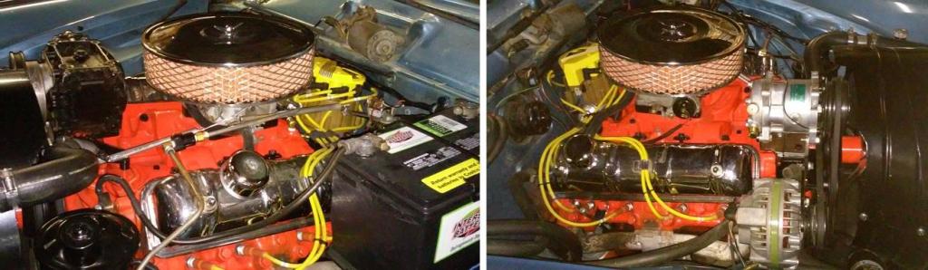

        Yes, its quite easy. You only need to figure a way to put a fitting for a tube there or a bung for a PCP valve. One way would be to remove the tube from the road draft tube "hat", block off the hole and add a small tube. That's essentially what the factory did when they first went to a PCV valve. As mentioned earlier you need some sort of baffle below the PCV valve so you only draw gasses. I have my valve mounted in the vacuum port on the left rear of the intake manifold and hoses going to the location you pictured and to the front of the engine where the oil filler stand mounts on earlier engines, that location goes directly to the oil pan, so it can draw front both the top and bottom of the engine. I'm using the late '63-4 valley pan that has the fitting in place of the road draft tube or PCV valve adapter. If you go to a PCV valve you really should also go to a closed oil filler cap with a hose going into your air filter assembly too. This way you'll have a closed breather system; you'll be amazed at how much cleaner your engine compartment will stay. I'm also using the late rocker covers with the oil filler caps on each. I have a breather hose going from each to the air cleaner assembly; I'm using '70s Ford breather filters inside the air cleaner assembly to attach the hoses, it seemed easiest, but a simple tube will work.

          Many thanks for everyone's help. I'd like to find one of those lifter cover adapters that Rich mentioned. Short of that, I'll just replace the factory tube.

              I've decided to cut my draft tube and braze in a PC valve to plug into the carb base. Looks like the carb takes a 3/8ths hose. Not having done this before - on any car - are PC valves all basically the same with one-way internals?
                They are basically the same. I would not advise brazing the PCV valve. It has a spring inside, and the heat from brazing will probably screw the spring up. Braze a fitting, that you can screw the PCV valve into. That way you can change it on occasion, which you should.
