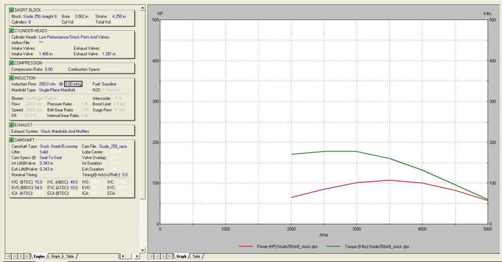

                    I don't think there is much to be gained by changing the cam profile. When I was building my Indy car engine, I tried a bunch of different cam profiles in my engine modeling software as well as other hop-up techniques. The profile used in the 250 cu in straight 8 is a pretty good one for delivering torque at low and mid rpm. I think the same timing was used in the 245 cu in Commander six and later 170 cu in sixes. High end rpm will be 3500-4000. Stock lift is 0.343 inch. Adding more lift doesn't change much. Since you don't plan to go racing, adding more carbs isn't part of your plan, though that seems to be the nearly the only way to get lots more horsepower. You could take a little off the head to raise compression but are limited by the valves hitting the head.

                    Computed horsepower and torque for stock 1937 President engine, matches factory data. Dyno 2000 software.
