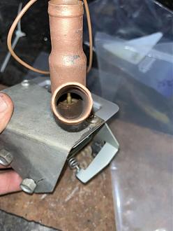

    I've been enjoying the search feature for the last few hours and have learned some great stuff, but I do have a question I couldn't find an answer to. I'm currently replacing the heating system in our Cruiser, it has never been in operation since we've owned it, the hoses were missing and the core appeared to be in poor shape.
    Is there a way to bench-test the control valve?
    Should I just bypass everything under the dash, install it under the hood to test?

    Looking at it's condition, I would say it will be futile to waste time on it. It is very likely Original and 59 years old and Plugged up and or leaking.
    If you have the time and patience, the 2 Repair Seals are available at NAPA.
    Reconditioned, New (NOS) or Lifetime Ball Valve Replacement Heater Control Valves are out there.
    These are "Ranco" Thermostatically or Manually Controlled Coolant Valves, made to fit Studebaker's only, but similar to Chrysler Products and others.
      If someone has a way of bench testing these it would be nice to know. Thank you
        Operate the control and see if the little plunger that protrudes from the back of the copper spigot goes up and down. When up, you should hardly be able to blow through the valve. MMM, tasty. These valves held up really well and I hardly ever had to rebuild them til they were 40 years old. Now, they ALL need the new diaphragm in the Napa kit 660-1000.

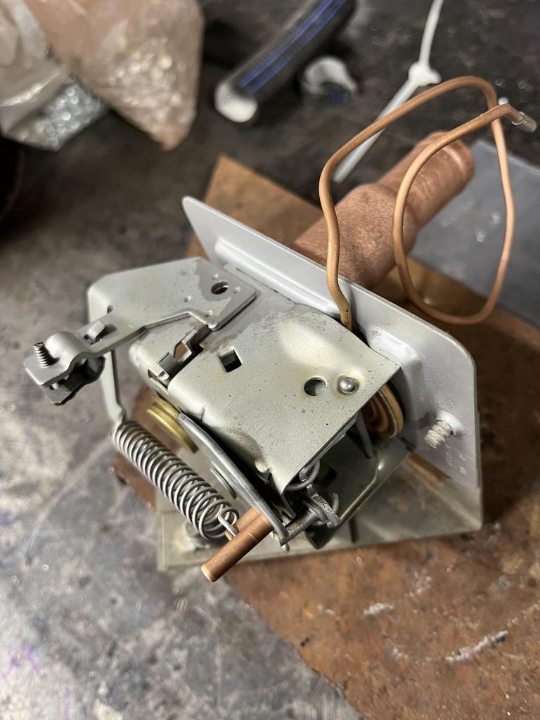

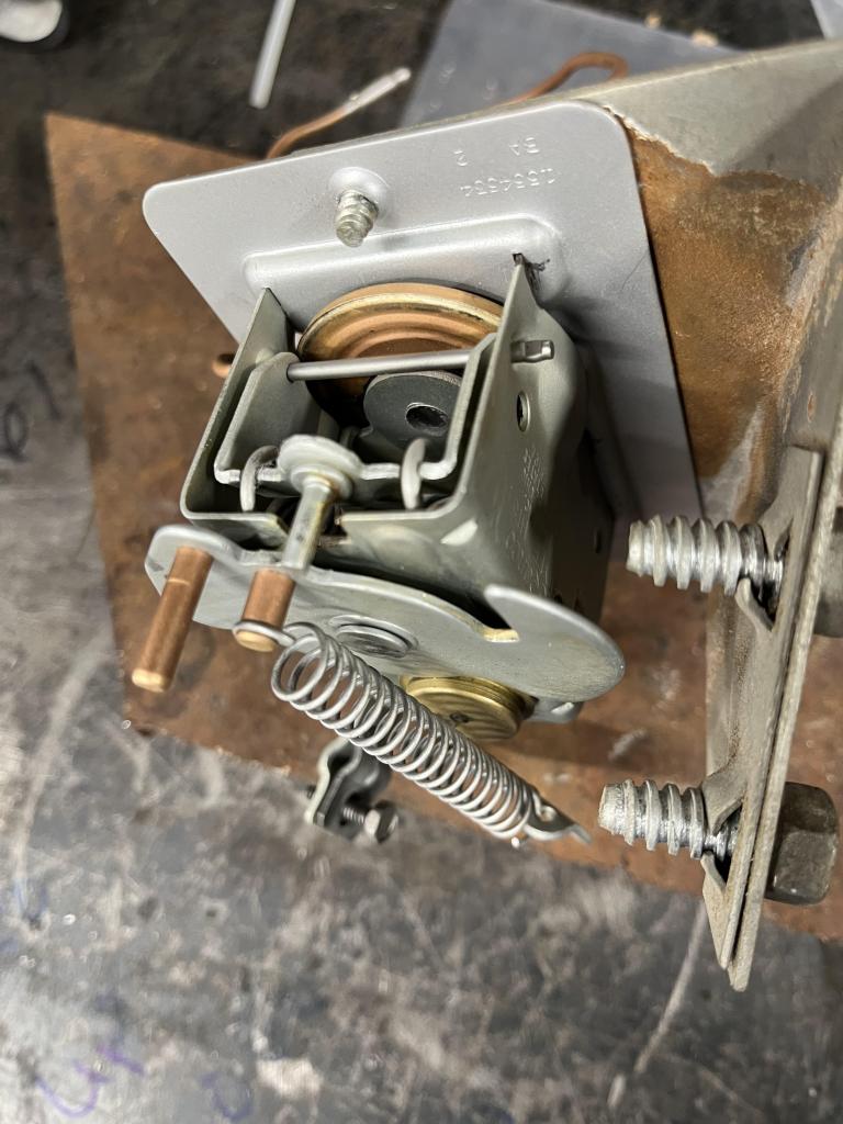

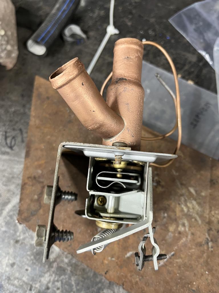

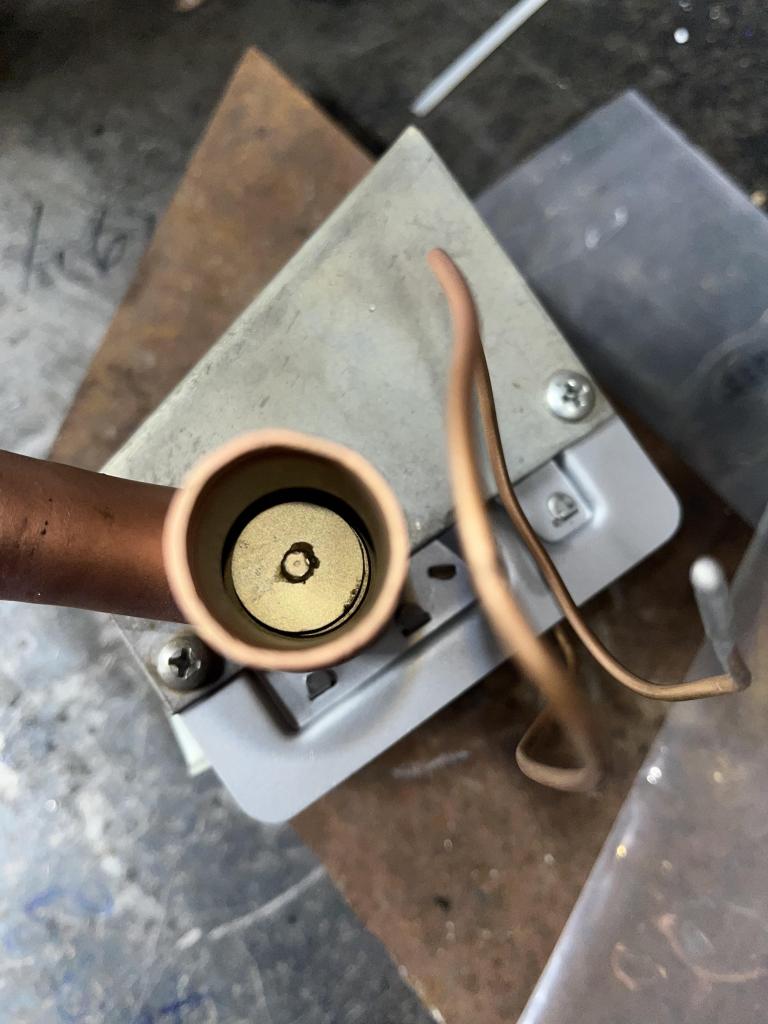

          Thank you I rebuilt mine and it has a new diaphragm, the only one I have done, just want to check it out before I reinstall it and watch it leak.
        Ended up having Joe Hudacek rebuild it. Looks great, nice guy. Getting ready to install it.

          Looks great! Does Joe replate the zinc-plated parts, or are they painted?
          Paul
          Winston-Salem, NC
            Nothing looks painted, most likely plated. Didn’t even think about that, I was just amazed how new it looked lol
