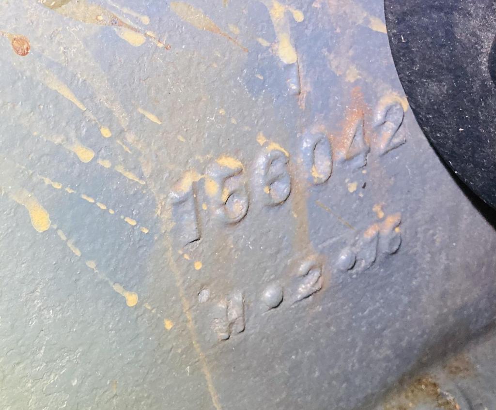

      Doesn't it have raised Casting numbers on the Head and Block and maybe even a machined flat Pad on the Left Front side of the Block with a STAMPED into the Block Engine Serial Number like all newer Studes. have?
      If you post those Numbers we could tell.
      I don't see a Graham coming from the Factory with a Stude. Engine but it COULD have one Now, someone familiar with "Old" Studes. will know by the Look of the Engine.
        Surprise! It actually is a Stude engine. Look for a stamped engine number near the top of the block, left side, above water inlet manifold. Should start with an 'F'.

          Not so fast, gents! Note that the engine does NOT have a water pump on the side of the block, it appears to be in the front. I thought all Studebaker 8s prior to 1938 had side-mounted pumps. Any chance this is a Pierce-Arrow block? But, as Dwain says, let's see the serial number on the side of the block plus the casting numbers for the block and head.

                the number cast on the block and head is 156042. same number on both. it has a 3 speed transmission

                  I ordered a gasket set for a 1930 graham paige super 8 motor and nothing fit. Since then I was told it was a studebaker engine--kind of weird that someone would change the motor & trans to an earlier model engine from a different car company. I have been told that because of the depression many small car companies were using parts from anywhere they could find them and stocks of their original parts were depleted. Block number cast on the head and block is 156042 and below that is H 2 16. Does that coincide with any studebaker numbers? Looks like a part number and not an engine number?? Thanks for any and all help--you guys are great!
                    If the cast-in number "H 2 16" is a casting date code, and if the engine is a Studebaker engine, then "H 2 16" would mean 1928 February 16, or Feb. 16, 1928.
                    --Dwight (have documented these casting date codes back to 1922.)
                      Great information Dwight—thank you! It has the h.2.16. Cast on the block.. There is a stamped number on the block which is 737001 that coincides with Graham Pierce and is on the title.
                      Is there any record of studebaker engines with the 156042 series engine numbers?
