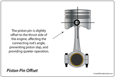

          Got some calipers?
          I'd measure for piston pin offset. On the order of .06" so it will be very obvious with a basic caliper measurement.
          The lack of an arrow on the top does suggest the pistons do not have offset pins.
