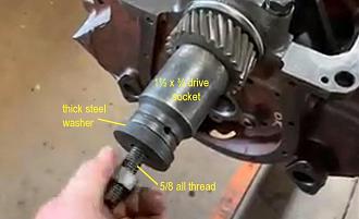

    Pusher tool to install timing gear
    shaft is 5/8 all thread welded to crank bolt.
    Click image for larger version  Name:	PusherToolShaft6.jpg Views:	0 Size:	38.6 KB ID:	1958804
    then stack a 1½ socket 3/4 drive, thick washer
    Click image for larger version  Name:	PusherToolShaft7.jpg Views:	0 Size:	50.7 KB ID:	1958805
    Anyone have this to loan out ?
