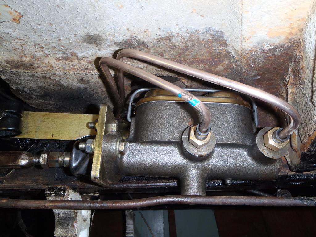

      Having had a wheel cylinder fail on my single-circuit system and experience my brake pedal go flat on the floor, I will NEVER advise someone NOT to convert to a dual master cylinder.
    I assume you want to replace the single master cylinder under the floor with a dual MC. If so, Jim Turner sells dual master cylinder kits for GT Hawks. They include the already-bent brake lines needed to install the MC. His website is:

            I used Turner's mount and an AMC Master cylinder.
