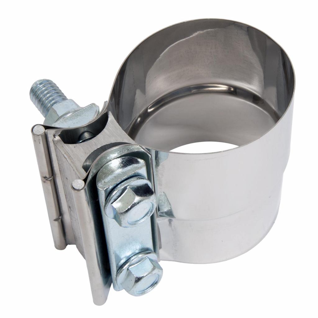

      Avanti R5407 got a new exhaust system made by an unknown shop in Mass, and installed there. It leaked everywhere! I have always used muffler cement successfully, although it makes the pipes harder to remove.
      One solution is the stainless steel band clamps -- see pix.
      --Dwight

            Plus one big time on the band clamps!
