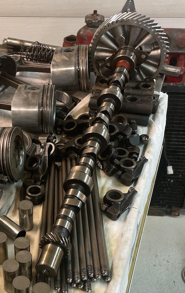

              Hi 64Studeavanti. I dont have Cam near but here is the photo. Correct one? Should be.
              Studebaker Avanti R2 1963. Gray. 4-speed.
              Las Vegas Driveaway.
                Looks correct. Easiest way to verify is to count the lobes. Should have 16. If you have 17, you have non-"R" cam. Post the casting number and we can verify. I have NOS to compare to.

                  Cam casting number should be 1557663. It is located near the distributor drive end and is in 2 rows. Non "R" cam is 534131.

                    Hi again. Thanks, I really appreciate your effort. All parts are now in machine shop. I will check that later.
                    I think all are correct R2 parts except the head and pistons are like Golden Hawk ones. Hope this combo works fine with Paxton and R2 carburetor untill I find the R2 Head. Ofcourse with thicker gasket.
