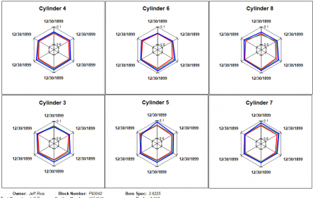

          Agree'd. Sonic testing does give you good info.
          Being systematic in your test methodology helps, too.
          Here's a method used testing a block.
          Sonic test was done in a clock pattern and at every inch down the cylinder.
          An Excel file was made to record the numbers and then a spider chart was created to visualize the results.
          What we have found (depending on year) is there are some thinner spots on the 12 o'clock middle on #3/5 and #4/6.
          A thinner spot on the oil drainback hole area on #7.
          T thinner spot on #8 low (full flow near 6 0'clock, by the oil filter casting boss).
          This is not a general comment, but what has been found on specific blocks.
          The only way you will really know is to test.
