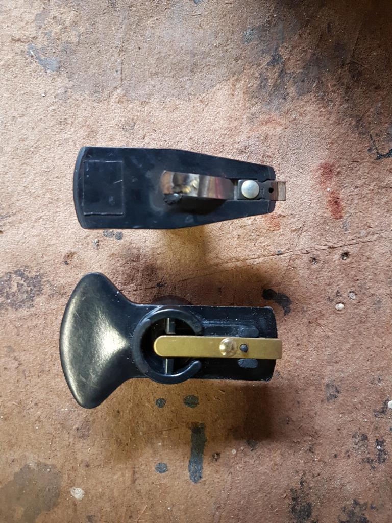

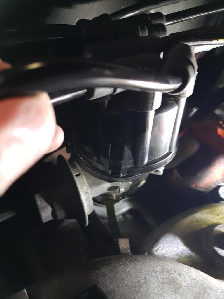

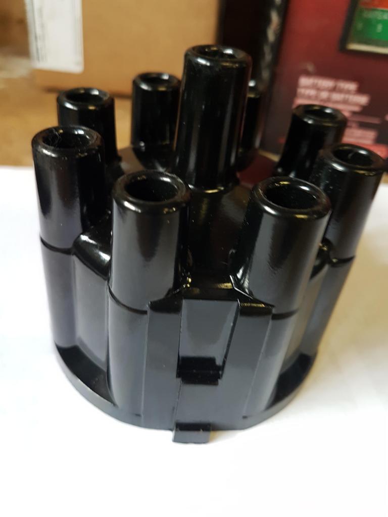

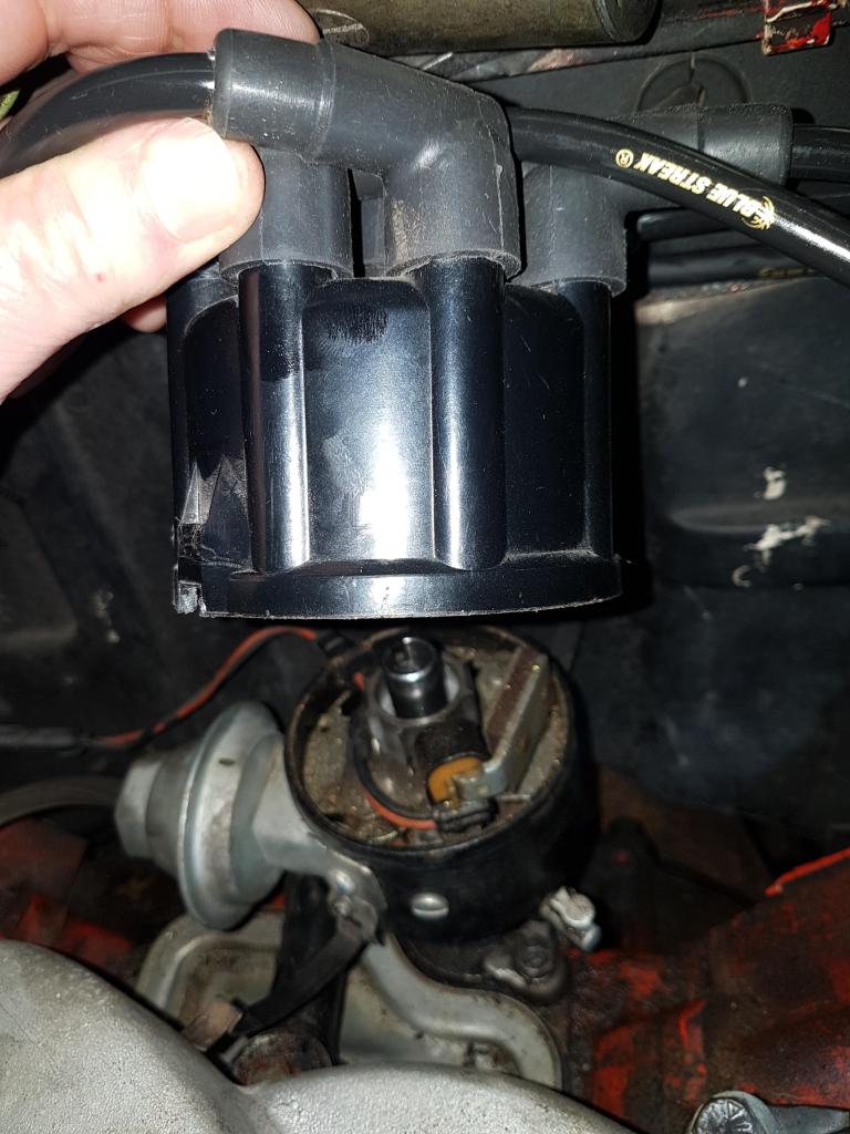

    The Prestolite rotor I received does not mate to the distributor shaft at all, it's completely different. The rotor on the car has a "key" type of attachment to the shaft and a solid contact on the top to make contact with the sprung contact on the cap. The rotor and cap on the car are the opposite with the sprung wire on the rotor and a solid contact on the cap! I get the feeling there may have been a few different ways to do this. I am going to give Dave Thibeault to get his thoughts!

      I spoke with Dave Thibeault. He used the cap and rotor from a Chrysler 400 without the lean burn system. I'm going to try and source that locally and I'll let you know if I have any success.

          The Distributor Cap is: NAPA/Echlin MO-20 or Standard Ignition: CH-409X, CH-409 or CH-409T
          Rotor: NAPA/Echlin MO-13 or Standard Ignition CH-303X, CH-303 or CH-303T
