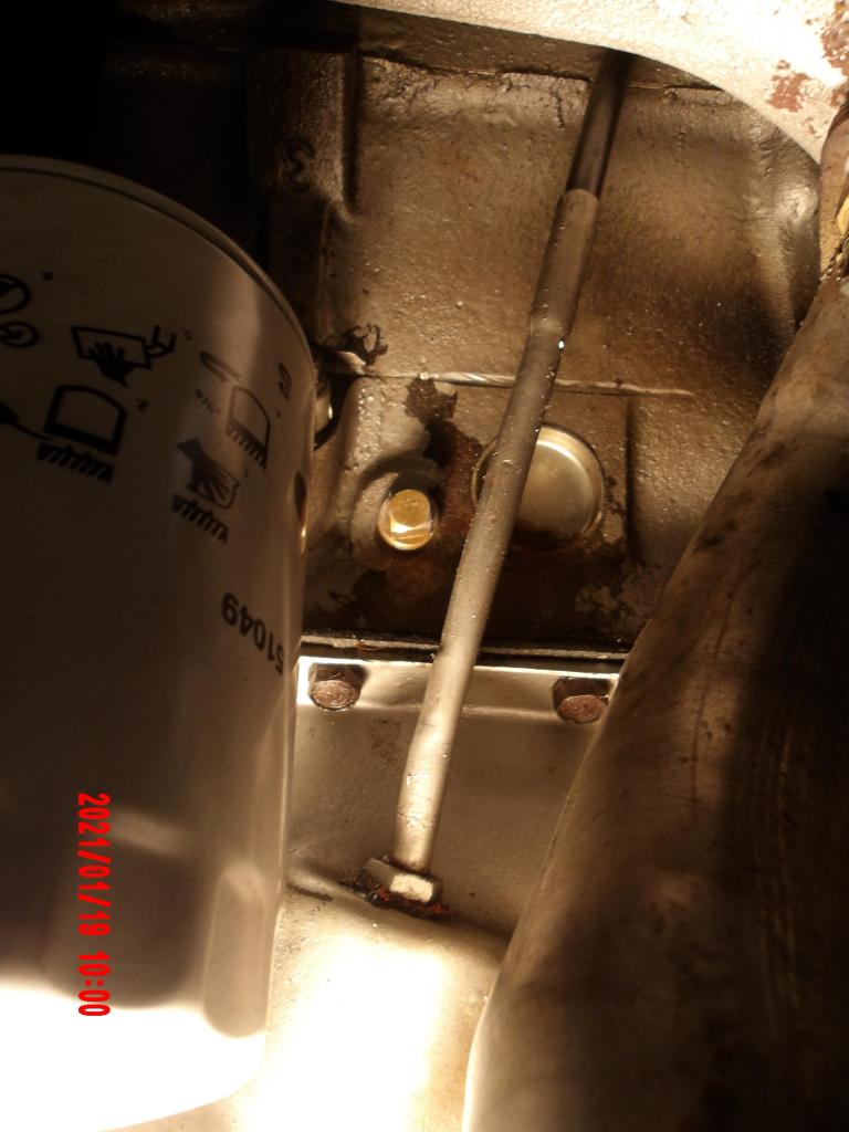

    The frost plug is OK. The hole on the block is corroded and it is obviously leaking around the frost plug. You'll need to remove it, clean the hole up really well, and replace it. Coat the lip with Permatex #2. SI sells brass ones that I've used and should last longer. Be sure it seats squarely. There are rubber ones you can buy, too. I've never used one but it would be far easier to install. Take the drain plug out, be sure it is new, chase the threads, and re-install with Never Sieze (which everyone needs one their shelf) But it doesn't look like the plug is leaking--that would be way too easy.
    • #17
      so i took another look, the block plug in question is brass, i scratched off the paint, what size are there freeze plugs? please
      do you think my tapping it with a drift punch helped seat it or is it FUTILE?...................um........yes i am trying to avoid draining the swamp

              thank you I did wipe it real good,
              even after upping the radiator cap from 7 lbs to 13, i lose no coolant to speak of, so for the average joe or jane, it would go unnoticed, not even staining the ground below it, so it is a small leak( weep, seep) however being an automotive enthusiast and a stude at that, and since the bottom of the car is my second home i saw it , while doing many things around it, so now this has come into focus or rather in my cross-hairs; it does keep the oil pan gasket wet, and i think it is made out of cardboard, gasket material, that can not be good long term
              is it urgent? , i say no, but it is on the list, meanwhile i am enjoying my newly washed lark, do you know where to get brass freeze plugs and what is the difference between deep dish and not?

                Biggest concern with the plug I see, is possibility of it blowing out while going down the road. Agree with someone else above, for the screw plug, anti seize is preferable over anything else, but don't tighten it too tight, maybe 10 ft pounds or so.

                          Buy both a shallow and deep cup in 1 1/2" diameter. Steel works fine; it will last for 20 years. Use the deep cup (about 3/8" deep) if the hole is smooth all the way in. Use the shallow one if the hole has a ledge in it. Don't mistake a buildup of crud behind the cup for a ledge. That stuff will scrape out with a pocket knife. A cast/machined ledge will be cast iron, and contiguous with the block, and show a square corner. I like to coat the O.D. of the freeze plug with Permatex #3 (the liquid Form-A-Gasket), and then use a half-inch drive socket that just fits inside the cup as a driver to install it. Get the plug square on the opening. Not tilted! Use a hammer to tap around the perimeter of the socket, inching the plug into place. Stop when the rim of the cup is flush with the face of the block, or just the tiniest bit deeper. It takes more time to write about it than it does to do it.

                            came out ok with a center punch to 12 o'clock area, it was not leaking because of a bad fit it was rusted out, i though the block was power washed for the rebuild, the other plugs looked solid; only 2 had holes, glad i checked i thought i was dealing with only 1 bad plug,
                            was surprised it didn't leak more, it was almost nil held pressure, the Stude cooling system is over engineered( wonderful)...... then i noticed the one next to it was rusted thru a little as well, i had another brass plug from SI, so I just had to take it out while i was at it,
                            is it rusty inside engine or good condition?
                            Click image for larger version  Name:	20210718_134307.jpg Views:	0 Size:	168.9 KB ID:	1903768 Click image for larger version  Name:	20210718_130650.jpg Views:	0 Size:	113.9 KB ID:	1903769 Click image for larger version  Name:	20210718_134235.jpg Views:	0 Size:	173.4 KB ID:	1903770 Click image for larger version  Name:	20210718_131057.jpg Views:	0 Size:	57.8 KB ID:	1903767
                            the first one went in straight, i was nervos about messing up the whole time, i used my black shellac stuff for insurance, it's like sniffing glue
                            with the second one, the dip stick got in the way, so i kept pounding it with a HF 3lb hammer( love that hammer)
                            and it went too far in ( such a newbie) you think it will hold?, it's in too far about 1/8"-3/16" dammit
                            i refilled new coolant 2 gallons and tap water done, such a hack job
