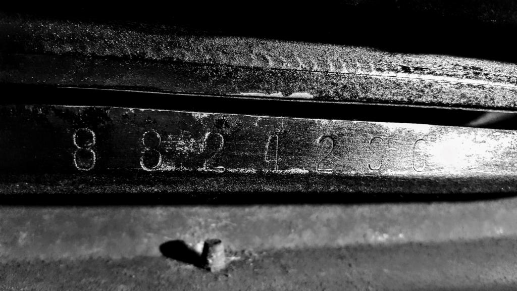

        On my 52 Commander, it's on the front flange of the rear crossmember, pretty much in the middle, facing the ground. It's an Arizona car so I'm sure it was easier to find than most.

              That is a Vernon (LA) assembled 1952 Commander.
