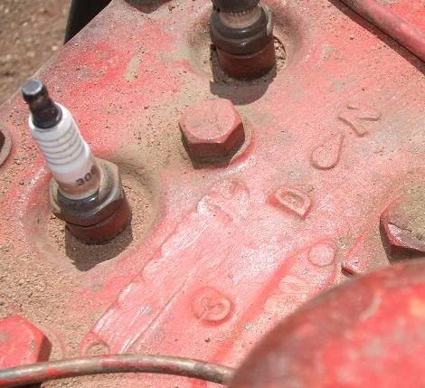

                      I should have a number for you guys this evening, but in the meantime here's a photo of the markings on the top of the head. Any idea what they mean?
                        That is an 8-hour 'clock' and a day-night shift indicator. I think the date code is below it and appears to end in an 'O'. For some reason Stude often tried to obliterate the date codes.
                        Dwain G.
