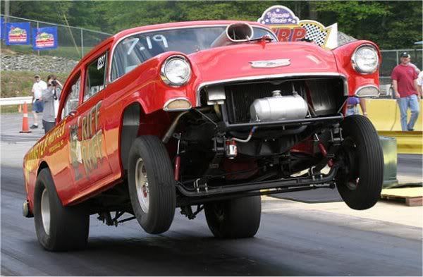

                          If, like me, you haven't heard of a Moon Tank, I found these pix on google's image search. So, is this what you want on the grill?
                          or this:

                            Hehehehehe. Well, either would be quite cool.
                            The orignal thought was your picture 1. Gasser style. Leave all the front hardware off and mount a tank. i.e....
                            TaDa! No more grill problems! I like this look a lot, but there is more to imitating a gasser than a polished moon tank. So I vey much doubt I will go that route.
