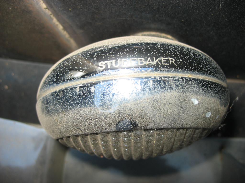

      Although mine is a Champion, it should be the same for Land Cruiser. I can't remember if this was factory installed, or dealer installed, but this is the correct light for 47-49 cars. The center of the hole for mine is about 2 1/4" from the bottom.
ID:	1728722 Click image for larger version
