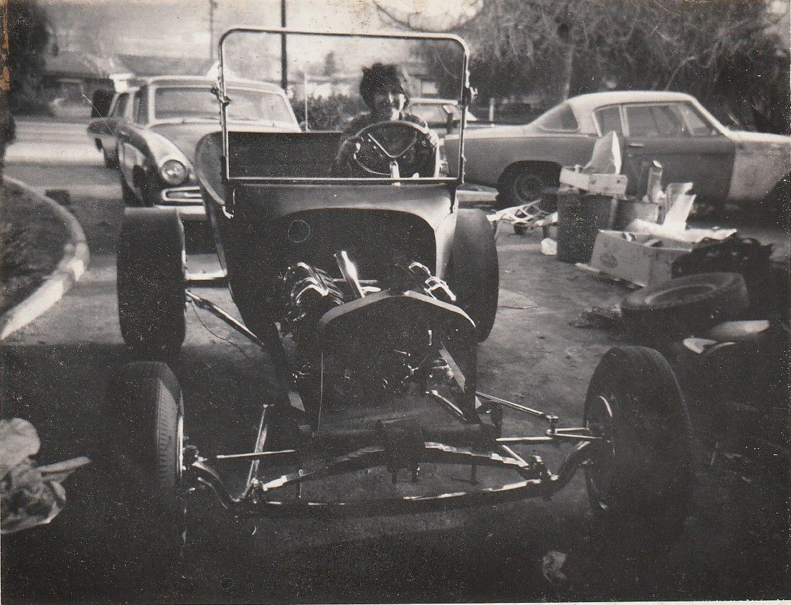

          You are right Jeff. I had a 61 T-Bird 2 seat convertible with a 390. Took it out to San Fernando Raceway and it ran 17.23 et. at 83 mph. My 53K with a 232 was at 16.10 and my Avanti R1 was running 15.25 et.
          [/URL]
          The Bird is behind the black K.
          • #20
            I have that same pic! Only my T bird was a '64 and my T was a '26. I 'll have to try and track it down.
