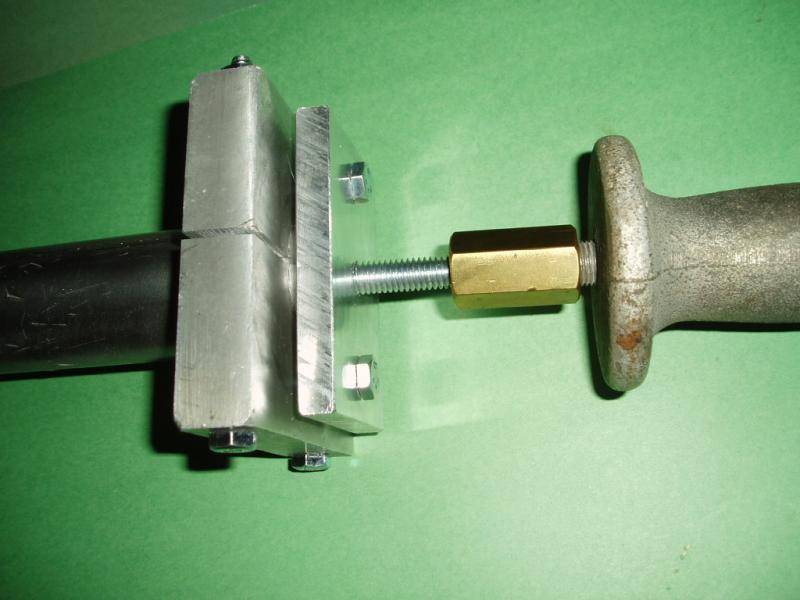

            For my Model A fill pipe I made a threaded aluminum plug to fit inside the top of the tube. Then I made a 2 piece aluminum clamp to clamp the pipe tight to the plug. My slide hammer pulls it out easily.
              Another method I have used is a muffler expander with an eye bolt under the bolt head. Then tighten it to grip the inside of the tube then use a slide hammer.

                Here's a picture of the puller I made, which pulls on the inside and outside of the pipe.
                I wish I'd have thought of the muffler expander Brad just mentioned. That sounds like a good idea, and much easier to make.
