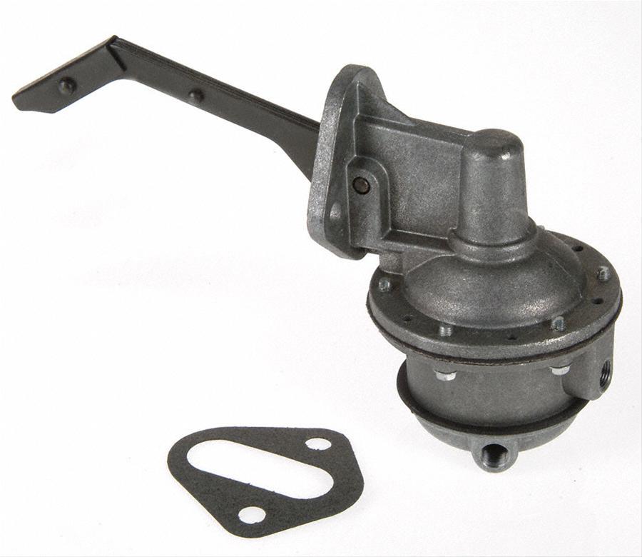

                          You need carter m2211 readily available at summit etc.

                            https://www.summitracing.com/parts/crt-m2211
                            Carter Mechanical Fuel Pumps M2211

                            Fuel Pump, Mechanical, Studebaker, 259, 289, Each
