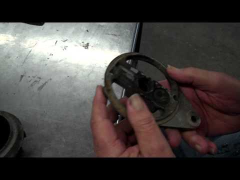

Google your generator # and find a kit for about $10. Take yours apart and replace the bushing, bearing, then emory down the armature both thick & thin. Undercut the brush end of the armature with a utility knife (grooves) with shaft end taped heavily. Put it back together with a few drops of oil in the cups, or grease/lube.... and away you go for less than $20. and a few hours tops !!! I'll bet there's a You Tube for it...
