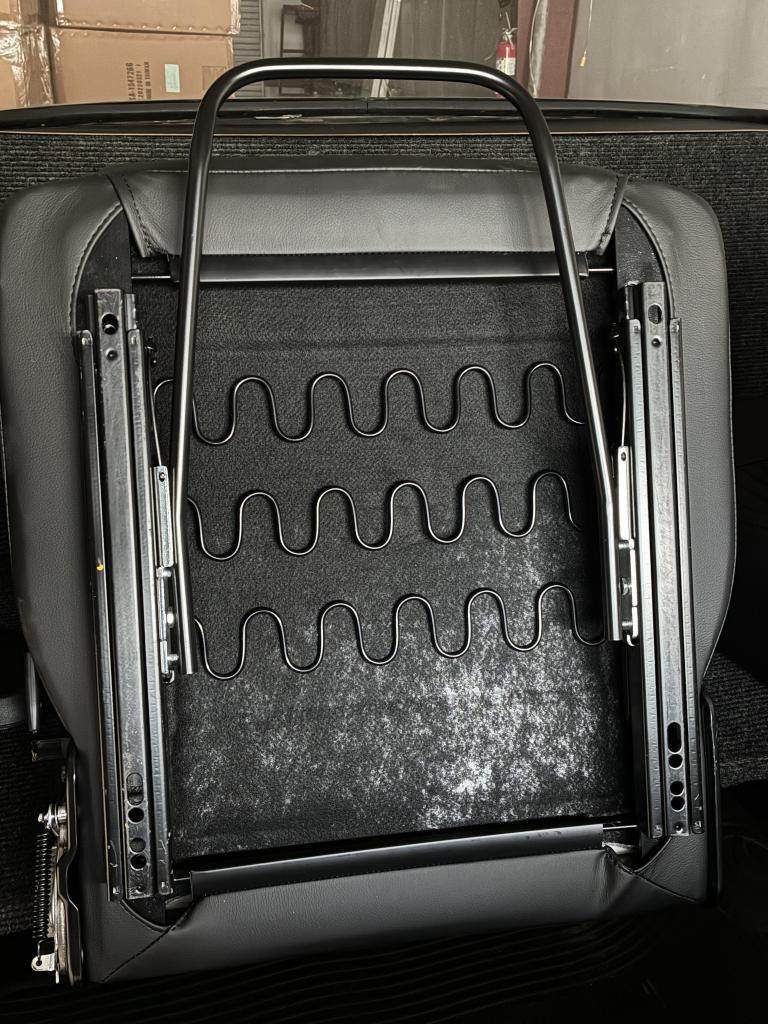

                            • Those look great Matt! I'm curious as to what your mounting brackets ended up looking like. Did you take any pics that you would be willing to share?
                              Paul
                              Winston-Salem, NC
                                This was the simplest (laziest) solution I could think of - I bolted a set of original seat tracks in the car and welded angle iron across them. I swapped the outer right and outer left tracks from one side to the other, to change the offset so that the mounting bolts on the seats would clear.
                                I centered the driver seat directly in line with the steering wheel, and then made the passenger side symmetrical.
                                The holes drilled into the angle iron line up with the holes in the seat sliders. The angle iron is fully welded to the tracks on the underside.
                                Passenger side shown in the picture.
