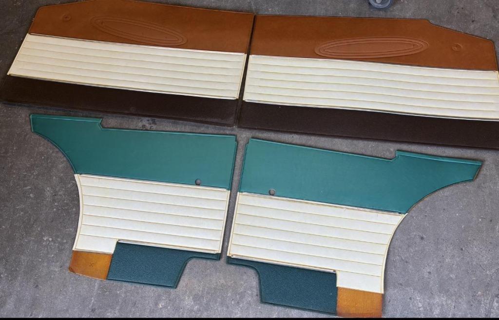

          While at the SDC national meet I picked up a complete NOS brown and white bucket seat interior (door panels, seat covers, and console cover), though I don't plan on installing it anytime soon.
          I also picked up a second set of door and quarter panels. I wanted black, though I could only get green and brown. But, that's what SEM vinyl paint is for.
          Click image for larger version  Name:	IMG_0249.jpg Views:	0 Size:	88.9 KB ID:	2070784
          Click image for larger version  Name:	IMG_0250.jpg Views:	0 Size:	90.1 KB ID:	2070785
          Click image for larger version  Name:	IMG_0254.jpg Views:	0 Size:	167.7 KB ID:	2070788

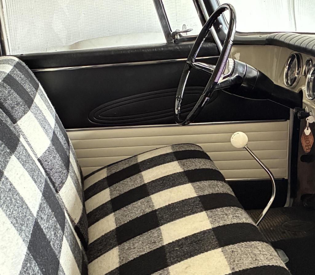

          • #95
            Front seat is in. I also made up another shifter handle for the Hurst, using an NOS one for bench seat Larks.

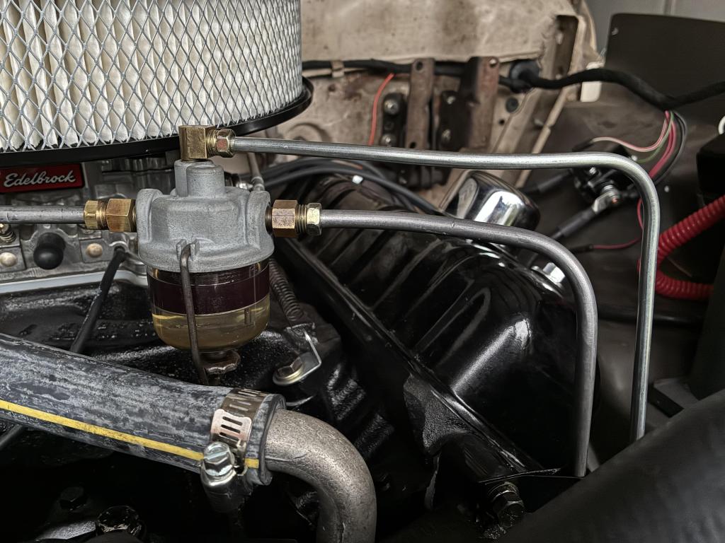

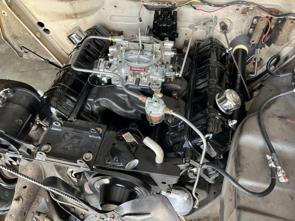

              The summer heat is finally breaking.. Which means more garage time and progress on the Lark.
              Today I ran a new metal fuel line from the tank to the pump, as well as a return line. Rather than drill a hole in the new tank, I routed the return line up through the trunk floor and plumbed it into the filler neck, mimicking the factory installed vent tube.
              I'm using an original (rebuilt) Avanti R1 fuel pump and filter assembly with the built in return line port.
              Click image for larger version  Name:	IMG_0364.jpg Views:	0 Size:	118.0 KB ID:	2071970
              Click image for larger version  Name:	IMG_0358.jpg Views:	0 Size:	37.5 KB ID:	2071971

                Good job on that fuel return line, should help with vapor lock, which I assume is why you are doing it. Putting the Holley EFI on my truck and that having a return line is one of the reasons I decided to give that a try.

                    Vapor lock prevention, and it keeps the higher fuel pressure from the R-series pump from potentially overwhelming the carb needle and seat.

                    • What is the bracket on the water manifold just above the fuel pump?
                      Bez Auto Alchemy
                      573-318-8948
                      http://bezautoalchemy.com
                      • Originally posted by bezhawk View Post
                        AC compressor and idler pulley mount.

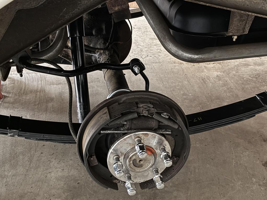

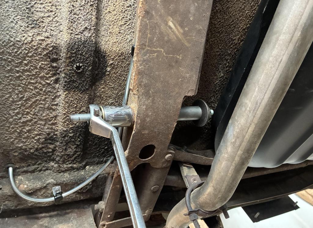

                        • This weekend's fun: New HD leaf springs, sway bar, and shocks.
                          I'd been dreading this just because of what a PITA it is to replace the shackle bushings in the frame. I don't think there's any easy way to do it (at least with the rear fenders and gas tank in place). For me it's always a fun game of finding out how many pieces of all-thread I can break.
                          Click image for larger version  Name:	IMG_0451.jpg Views:	0 Size:	125.4 KB ID:	2072553
                          Click image for larger version  Name:	IMG_0449.jpg Views:	0 Size:	169.5 KB ID:	2072554
                          Click image for larger version  Name:	IMG_0450.jpg Views:	0 Size:	189.9 KB ID:	2072555

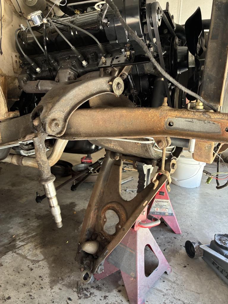

                              • Today's fun: Pulled apart the front suspension. Years ago, George installed Delrin inner control arm bushings, but for some reason didn't replace anything else. The tie rod ends, center bellcrank pivot, king pins, and outer control arm bushings are all trashed.
                                Good thing I have a great local source for Studebaker parts.
                                Click image for larger version  Name:	IMG_0507.jpg Views:	0 Size:	151.0 KB ID:	2073056
