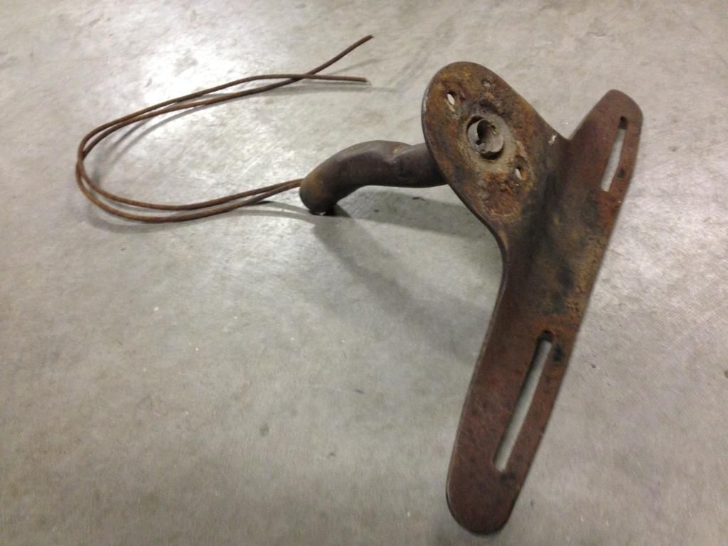

                    Aw, c'mon, guys! This has gone from the sublime to the ridiculous. I think SScopelli had his tongue firmly shoved in his cheek when he suggested the flag pole idea. Studegary was right on the money when he said tail light bracket. I tried to X2 that, but unfortunately referred to the flat stock bolted to the side of the frame as a "bracket" which threw people off the scent.
                    To get things back on track, the round bracket with the pinch bolt slot in it on the left frame rail is Studebaker part number 122898 and is officially called "tail lamp support bracket, LHC". The "tail lamp support, LHC" Studebaker part number 123074, (also referred to as "lamp bracket, LHC) and fits all models except the 4 passenger coupe or victoria, (part number 111264) is a pipe about 8 or 9 inches long and has a licence plate flange at the top. It is inserted through the hole in the gas tank cover and the pinch bolt tightened. The tail lamp (4 different part numbers) is bolted to the licence plate flange.

                      Here's one from my collection.
                      I own time machines.....
