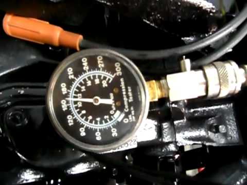

Today, I decided I'd better run a compression and oil pressure check before I got too far with assembly. Here are the results...
So far so good.
So far so good.
