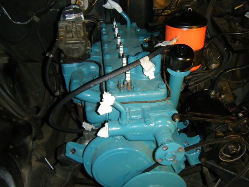

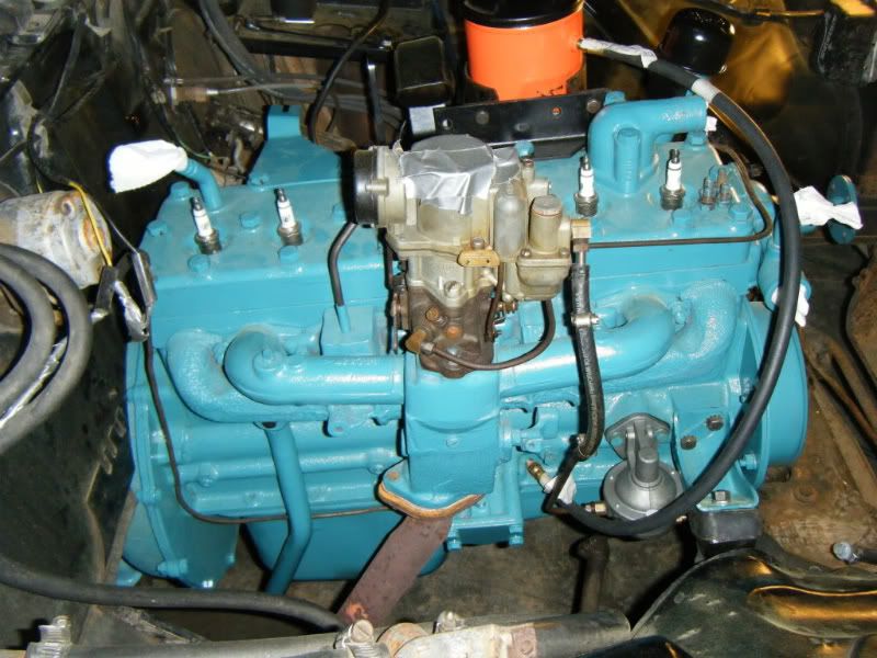

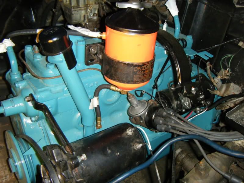

    Now how the heck to plumb the optional oil filter? I've given it my best shot, but wanted some expert help! Also I think I remember reading something about a restriction fitting in Turning Wheels, but can't seem to find that issue in the reading room.[V]
    Filter mounted to head and plumbed to the filler tube...is this right?
    Different view of above sowing pressure line at the top...
    Pressure line going over the head...
    Pressure line trying to avoid the hot exhaust...

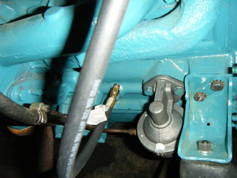

    Pressure line to be connected between the oil pump and fuel pump...

      Your routing and avoiding hot areas problem is caused by using those rubber (neoprene) hoses! The Fuel line to Carb. and the Oil Pres. line should be rigid steel. [:0]
        OK...rigid steel...I can do that...we've got a bender! Where should the pressure line be routed? Does anyone have a picture?
